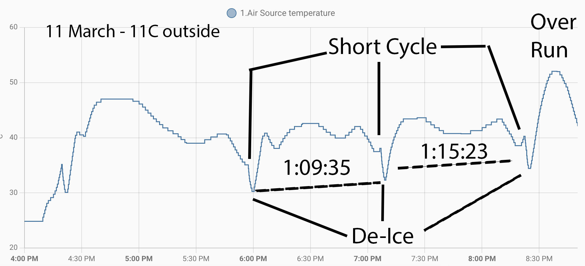

These thermal offs are where the heat pump turns off for 3 minutes and then 8 minutes latter does a de-ice.  This repeats itself under all conditions (inside/outside themos, different flows, etc).  See attached (note I used short cycle in my graph).

I am drawing the same conclusion that this system for some reason switches off for 3 minutes then 8 minutes latter does it's de-ice cycle.  It does this even when the outside air temperature is 20 centigrade.  Seems like it creates a lot of cycling unnecessarily.

Thank you all for your help, this has been a learning experience.  So in summary.  My heat pump is oversized, this causes Thermal Off’s or short cycles where is switches off for 3 minutes then 8 minutes later does it's de-ice cycle.  It does this every time it sees a short cycle and even at 20C outside and above.  It’s appears to be a function of the Hitachi system.  So how do I manage this going forward.  Longer term change the heat pump to a smaller one.  Short term:
