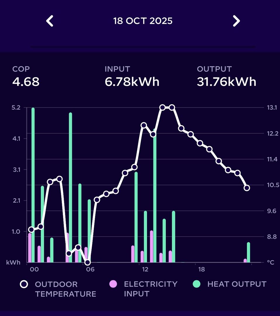

@jamespa tonight I’ve set the senso to 21 (it’s set to active), upped the curve from 0.4 to 0.5, and opened all the trvs. What I’ve noticed is after several hours the house seems stuck at 20.6c. It’s as if increasing the ft via the wc curve has had no effect.
Posted by: @adamk@jamespa tonight I’ve set the senso to 21 (it’s set to active), upped the curve from 0.4 to 0.5, and opened all the trvs. What I’ve noticed is after several hours the house seems stuck at 20.6c. It’s as if increasing the ft via the wc curve has had no effect.
If its set to active then the HP will adapt the WC curve (to an undisclosed extent and with an undisclosed timescale) to achieve the set temperature, so I wouldn't necessarily expect a small change in the WC slope to have much effect because its going to be opposed by the 'active' function.
The difference between 0.4 and 0.5 when its 12C outside is only about a degree anyway. This will anyway take some time to have an effect. Opening all the TRVs is a good, increases available system volume; getting the remaining rad in (I think you said you had one or more rad still to fit) also good. Do you happen to know your system volume, installer should have calculated it but it may not be in the documentation. Mine is about 200l; Im guessing yours may be a fair bit less.

@jamespa ive found out today the Thermix plinth heaters have an adjustable flow temp all the way down to 25c, which is adjustable via the wireless stat which controls both plinth heaters.
will have a fiddle when i get in.
@jamespa ok got home and I can indeed set the flow temp yay. So at moment I’ve set it to 27c which has lengthened the cycle time for the fans from secs to minutes. I think this might be better for stretching the compressor cycling as it’s shedding more heat into the kitchen. The house today has reached 21c but I’m not sure how much of that is the heat pump catching up finally or solar gain.
on the down side checking the flow rate it looks like I might have lost 150l/h so might have an issue with debris being eroded off by the flow rate.

@grantmethestrength yes took the main magnetic strainer one out last week and cleaned it, the flow jumped from 725l/h to 1100l/h. its now at about 985l/h. trouble is with the pump being on auto im not sure if that might be because at that moment it was modulating, though i did go into the test menu and have the pump setting on 100% before moving onto the flow rate reading.
