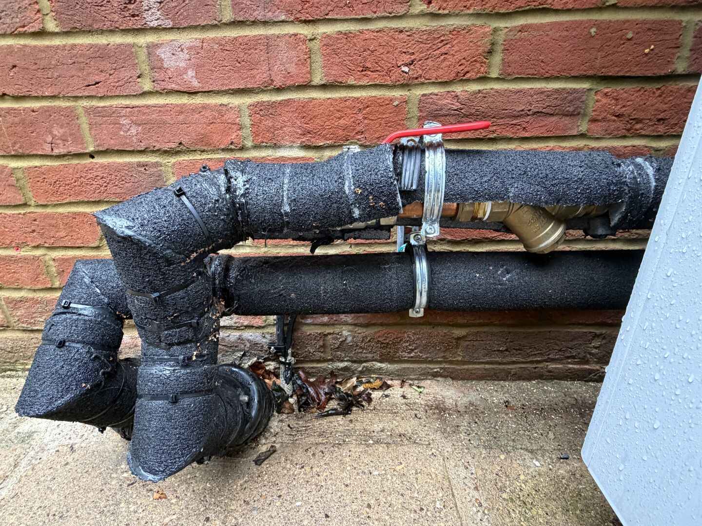

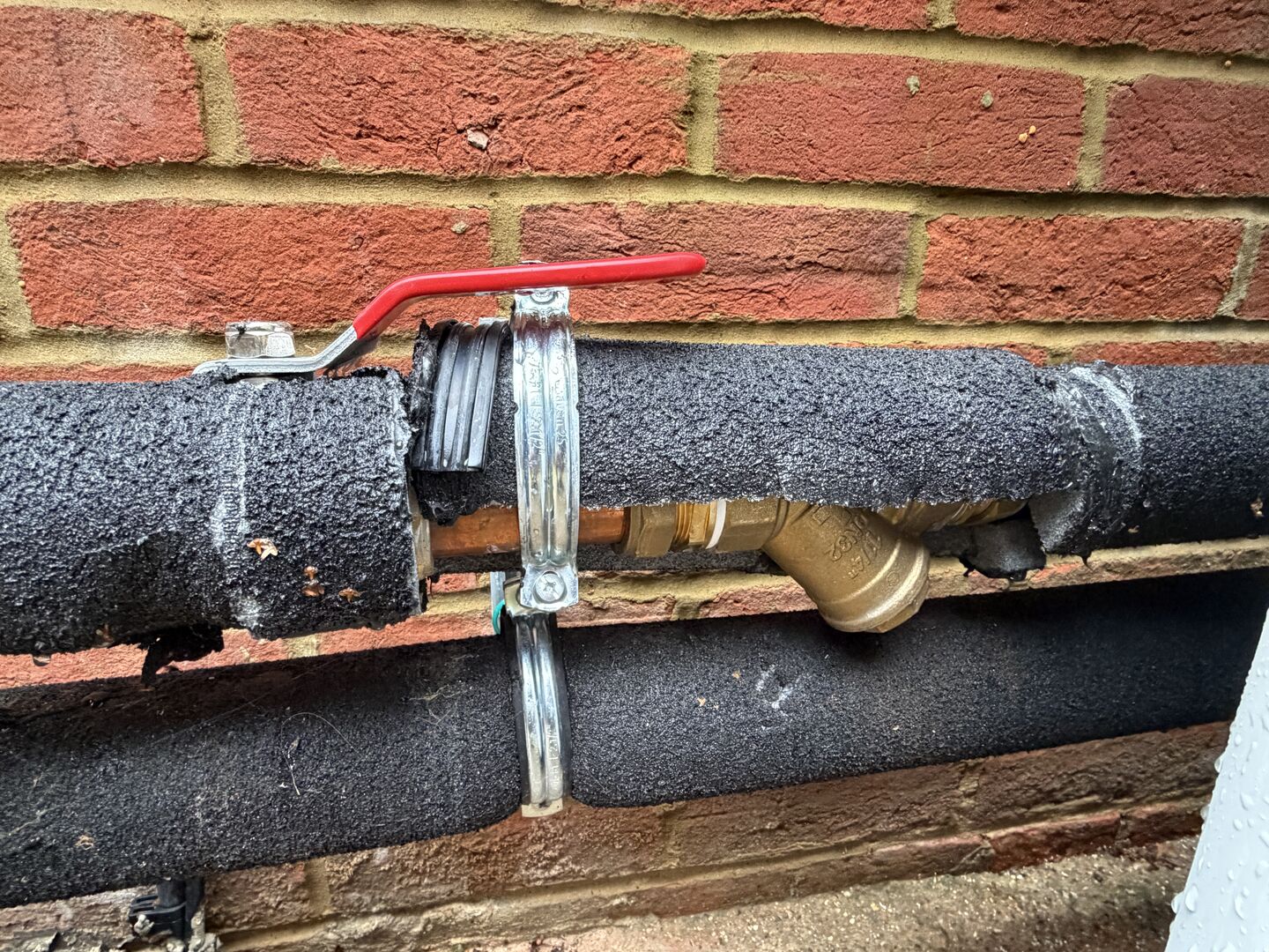

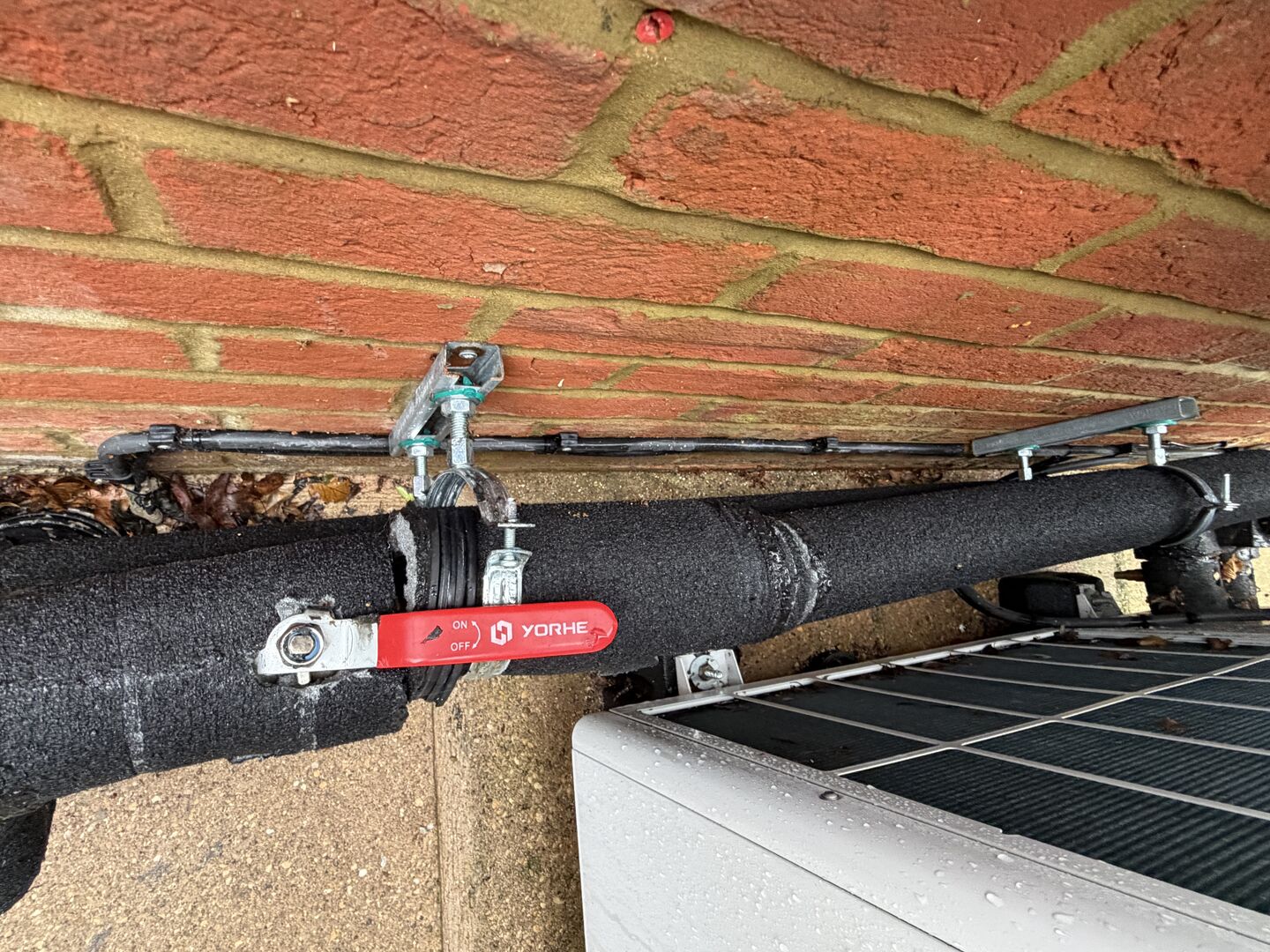

A while back I had a Y strainer fitted on the external side of the heat pump, during this installation the pipe insulation was cut and put back rather poorly, my service guy said when he was next in the area he would redo and told me to buy the insulation and just keep it ready, but as a temp he told just tape up the existing insulation with some armaflex tape and buy armaflex pipe insulation.
So my question is that the right stuff to buy and do?
IMG 0538
IMG 0537
IMG 0540

This sounds right up @transparent ’s street as he will be able to give you all the low down with catalogue numbers etc! Toodles.
Posts: 2859
Have a look at this previous post where I talked about Armourflex lagging with some photos.
Kaiflex is similar, and I mention it here with links to thesupplier, BES.
The sections of pipe insulation should be glued together using a contact adhesive.
That's the type where you apply it to each face and then wait until it's touch-dry before pressing then together.
You absolutely must have rain-tight seals to prevent water running between the pipe and the outer insulation.
Where the insulation stops at the rear of the heat-pump and where it enters the house, use CT1 or Plumbers Gold mastic to make it weather-tight.

Question the current insulation you see, does that look like Primary Pro? If yes what are your thoughts on that it looks like all the joins have been sealed with some kind of glue/liquid
I'm asking because if it is that then I may be able to buy a new length, they also do ball valve cover although not sure yet how I would get that on, and then for the Y strainer portion I have seen these insulated jackets and so I would replace that section and glue to join together.  Just a thought.
13.6kw Solar, 40kw Battery, 10kw Heat Pump and EV Cars
Posts: 2859
I don't think we can tell from a photo whether your existing pipe insulation is Primary Pro or not.
It may be another brand. The main point is that it must be UV-proof.
Primary Pro has an external UV-resistant coating, whilst other manufacturers use a material which is resistant to UV all the way through.
Nor can I tell if the 'filler'/glue used in the existing joins is UV-resistant, or merely a silicon mastic.
The black mastic used for guttering repairs is UV-proof, of course.
The wall thickness shouldn't be reduced by the use of nylon cable-ties to hold the insulation in place.
I don't resort to buying specialist insulation to match particular fittings.
Instead I buy 1-metre lengths of insulation with larger bore-sizes and cut them to fit around valves and connectors.
Where insulation of different diameters join together, they can be over-wrapped with Armourflex tape or similar.
Your existing lever-valve is tricky because it's been orientated with the handle facing upwards though a hole in the insulation.
I would slightly loosen the nuts at each end and rotate the entire valve so that the handle exits below the pipe.
That will prevent rain entering.
But you may not have the necessary spanners to achieve that of course.

Oh Dear! that's appalling pipe work, should've been in trunking to start with, and ideally not go through the ground, such odd bends! The industrial brackets look poor on a home, I'd consider boxing it all in with a removable cover, the unit is too close to the wall which means the fan draws even more air through over the pipe work.
