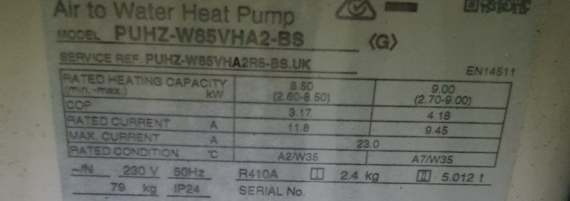

Heat Pump Model: PUHZ-W85VHA2-BS

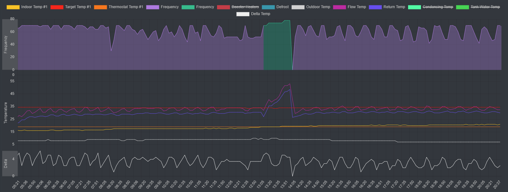

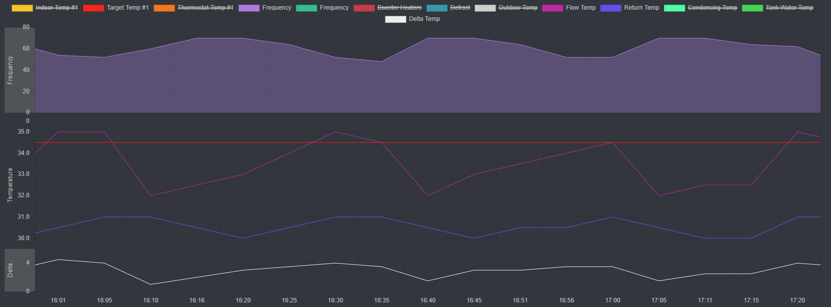

Medium load - (Outdoor temp 7-9 degrees)
- From 0520 - 0820 flow temp is below target temp (35 degrees) and compressor frequency is fairly stable while load is high and system aims for target.
- From 0820 - 1000 the flow temp seems to match the target temp. Flow (and delta t) stabilise and frequency appears to modulate down in steps.
- Rest of day. Compressor and flow temp fluctuating.
- Energy Use during this time (according to smart meter app): 35-40KWH (1.25 - 1KWH per hr)
- COP Heating: 2.41
- COP DHW: 1.11

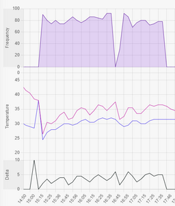

Looking at a close up between 1600 and 1720

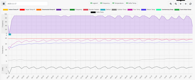

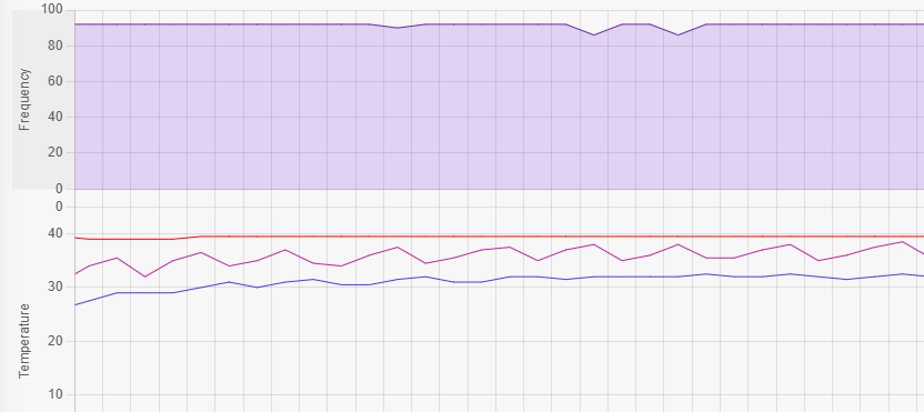

High Load - Outdoor temp ~-2
Observations
- Steady frequency of 92Hz
- Fairly steady increase in Flow and return temps, but Flow can be seen to fluctuate up and down despite constant compressor load.

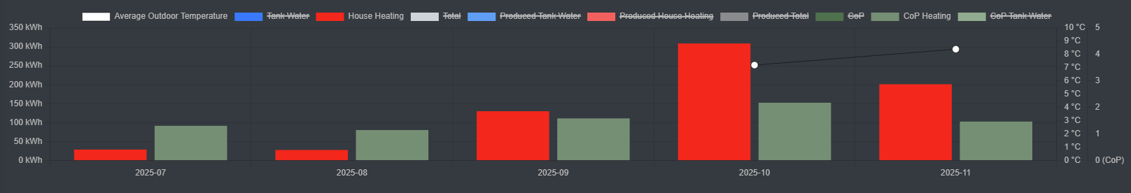

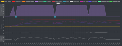

Daily Breakdown (Total Consumed KWH, CoP Heating, CoP DHW) for October
Daily Breakdown (Total Consumed KWH, CoP Heating, CoP DHW) for November. Note: data reading between 2nd Nov and 9th Nov is incorrect as I mistakenly adjusted the return thermistor (THW2) reading resulting in lower than actual reported COP figures. All thermistor offsets are now at 0.)
CoP Heating and Energy Consumed for Heating only by Month
- October Heating COP=2.18 for 309 KWH consumed
- November Heating COP = 1.47 for 201 KWH consumed. (actual values likely higher due to mistake mentioned above)

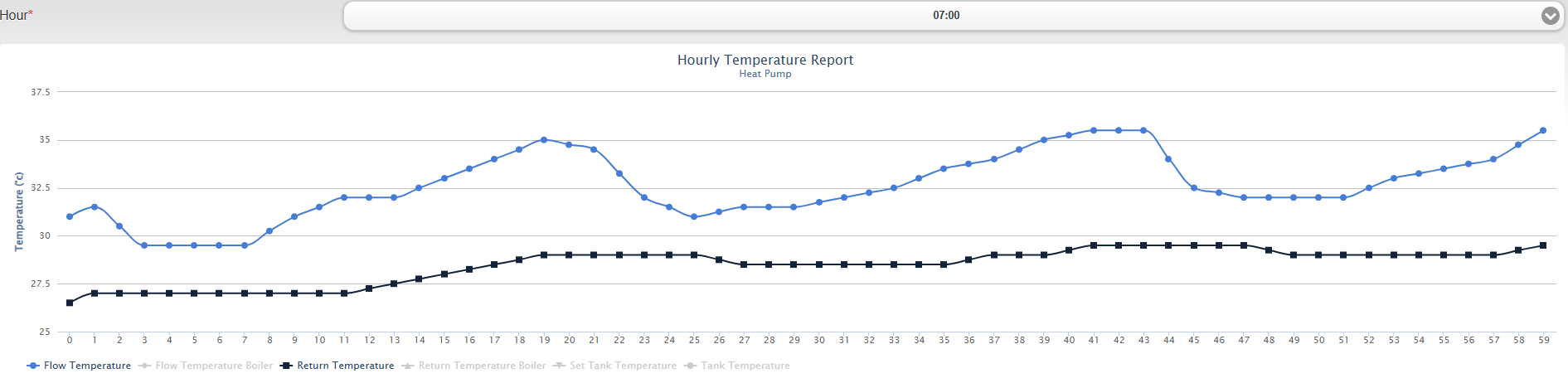

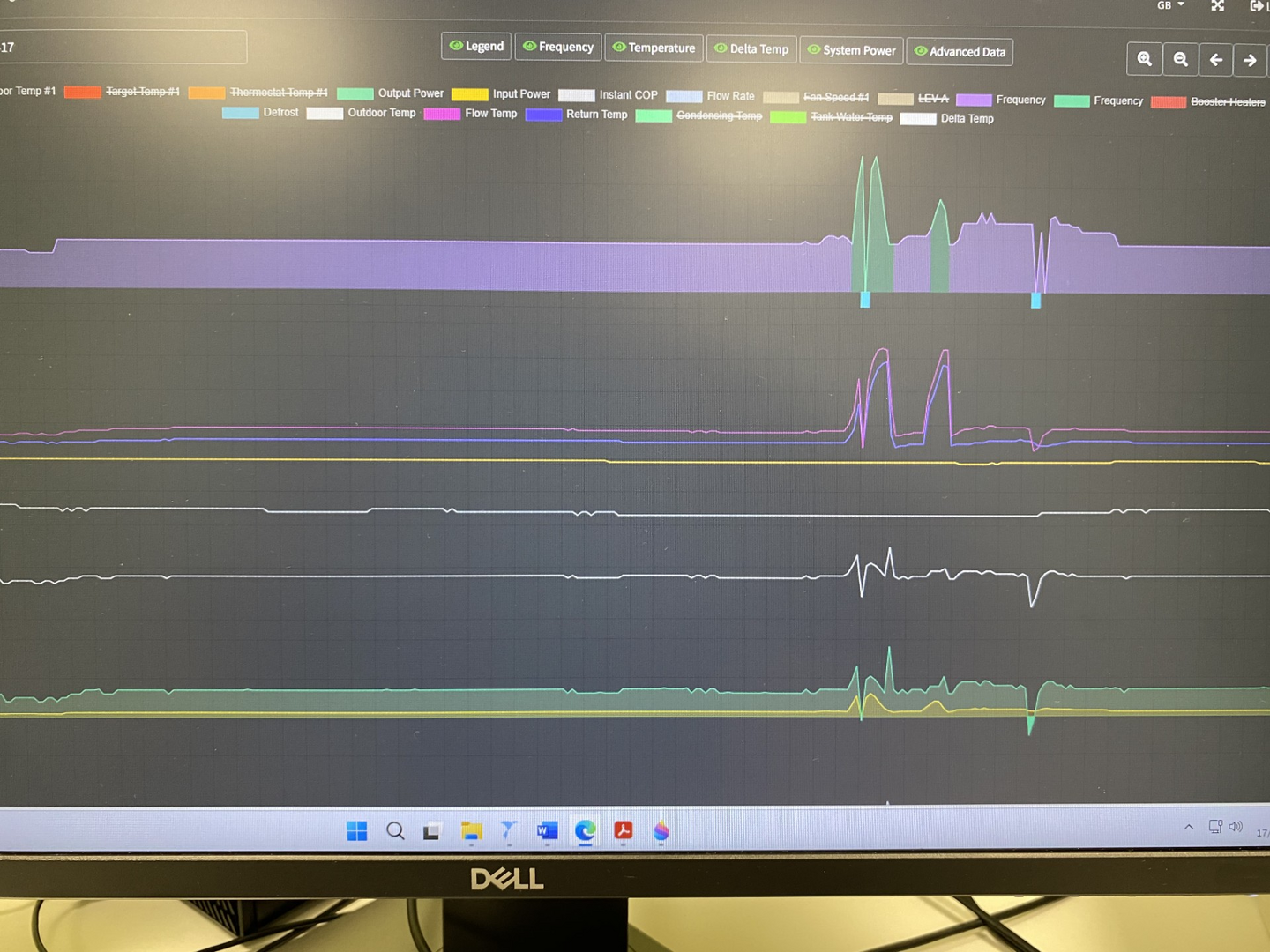

My main question at the moment is, should the flow temperature fluctuate so much? Even with a stable compressor frequency, the flow temp fluctuates up and down by 3.5 degrees or more every 10 minutes. This seems to happen regardless of load and temperatures so maybe it is just normal behavior but seems a bit strange to me.

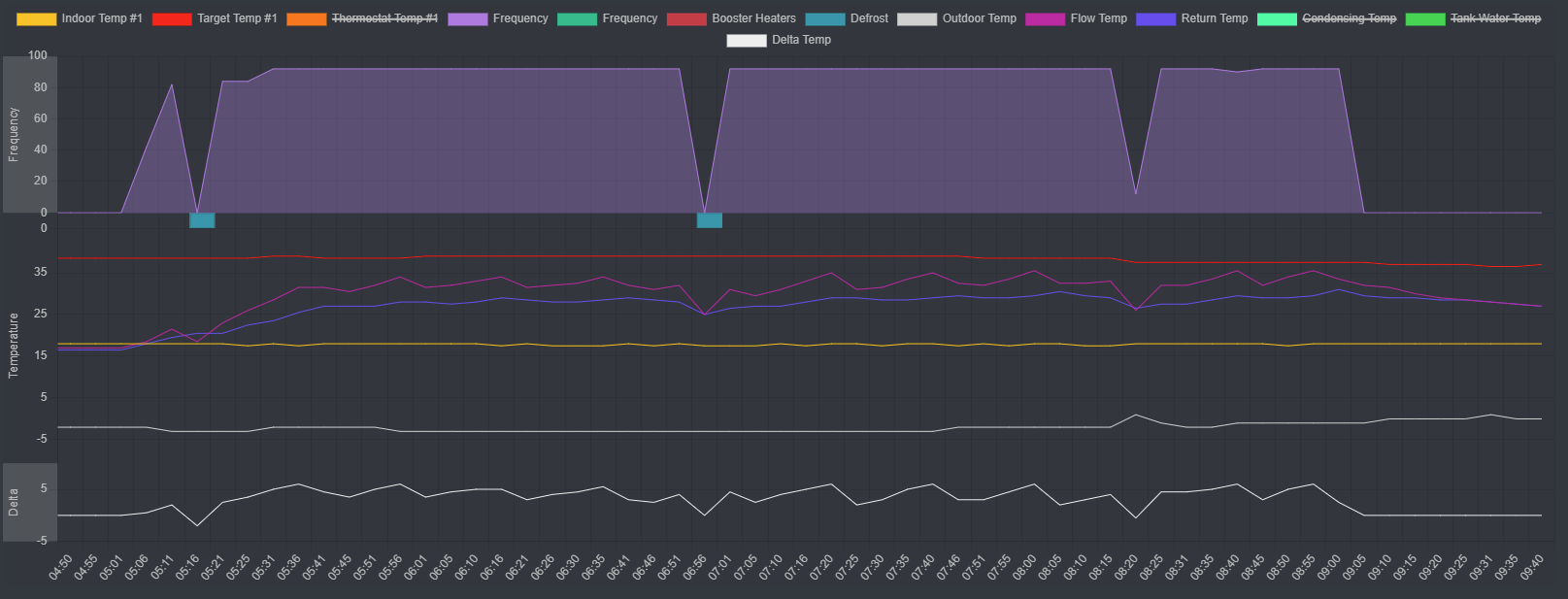

Here is my last 24hrs, its very stable and steady. its likely complex why yours is doing what it's doing and without knowing the set up, will he hard to get to the bottom of it. Those are quite high temps for UFH. Even when its stable, the compressor is running at 90 odd Hz, that is working very hard. the graphs look odd to me. you probably need someone to see how it's all piped and working. are you running zones? are things coming on and off all the time?
Thanks for the graph. That's really useful!
Agreed, these temps are too high but behavior is similarly chaotic at lower flow temps. First screenshot in thread was for 35 degree flow at ~5-10 OAT and behavior is similar. I will reduce further and get further screenshots.

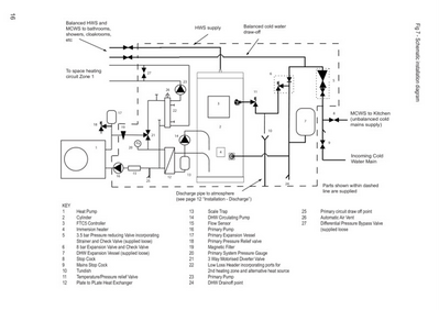

UFH and RADs are running on a single zone. Piping is as shown below, with only difference being that the RADS and UFH simply split at a T junction to divert the water to each. Only flow control for the RADs is the Lockshield valves. Each UFH loop can be individually throttled - all are full open besides one short loop that is throttled to reduce return temp slightly. They are approx 1.5 - 2.5l/min. All room thermostats are fully open and set so high they will never close. All radiators warm fairly evenly.
At this point I have tried everything including balancing the system, running pumps at different speeds to prevent recirculation through low loss header and also adjusting flow temps. Although I see some minor differences, I think the problem goes beyond simply having an unbalanced system. I feel there is something wrong with the outdoor unit resulting in these unhinged flow temperatures.
