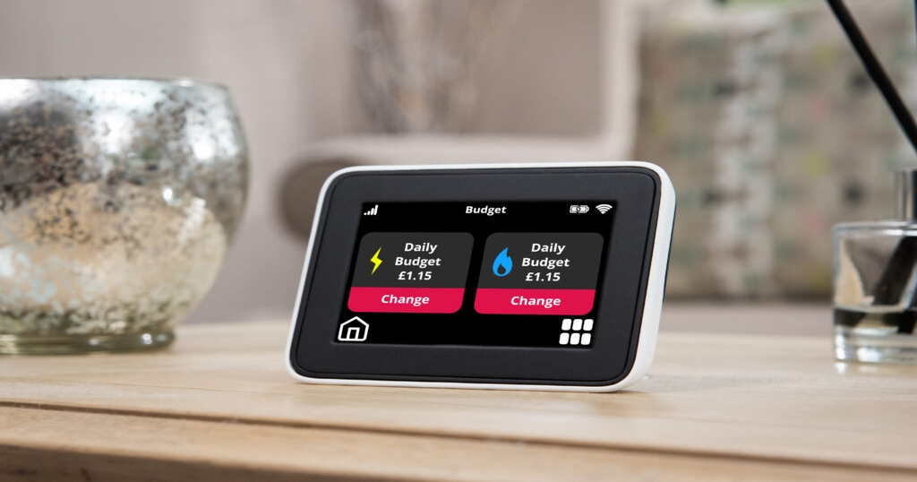

If you have a smart meter and gas heating, you have in principle very accurate data on demand. It's not entirely easy to interpret, and some additional info may be needed on heating patterns (particularly spatial patterns, ie heating only some rooms - temporal variations are evident from the data) but most of the data needed is there.
I would strongly advise to compare smart meter readings, if you have them, with any spreadsheet calculations if only as a sense check.
I'd lay odds that Octopus are working on using the data they already have more intelligently.
The combination of a smart meter plus a couple of cheap temperature/humidity sensors would absolutely nail it. Together these would give enough data to calculate load, house heat capacity and much more if properly processed.
Posted by: @jamespaIf you have a smart meter and gas heating, you have in principle very accurate data on demand.Â
for those not aware, hildebrand glow brightapp allows you to get your own hourly gas data for free, regardless of supplier. I used it during my own analysis 2 years ago.
