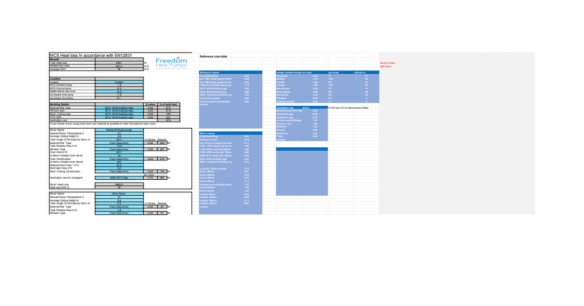

I'd suggest he goes through the house and does a heat loss and radiator calculation - room by room. Find out your heat loss and radiator power. I assume an 80 degree unit is really inefficient. We have a 260m2 house and the gas boiler is set to 45 and we are fine, not cold in any way. My guess is your radiators are crappy and your house isn't insulated very well - so you are just losing heat hand over fist. You'll need to spend as much (or more) in terms of gas heating for your house (depending on efficiency), the source of the heat is irrelevant.
Also, what is your electricity tariff? Have you moved to the lowest cost supplier?
Below is a sheet where you can go room by room to do a heat loss - just make your own copy. If you don't know, you cannot do anything. We need to measure, before we can have an impact.
https://docs.google.com/spreadsheets/d/1HAGXEC7WOhjsmXFf8Noh9CUvafc8E-DvoKn96zehmYc/edit?usp=sharing
