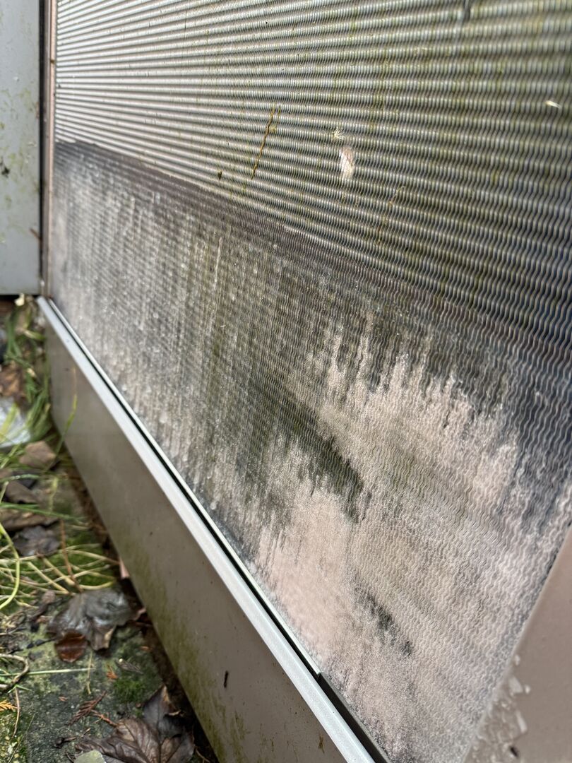

Roll forward 3 years and the unit has started playing up. Was fine until about October, when the temperatures dropped. I’m waiting on an engineer to come out having raised it with the installers first. Sent them a picture (unit is freezing up and the lower rear side, with ice over the grill) - no defrost function seemingly. Awaiting on engineer to arrive next week. Initial suggestions ranged from not enough water in the system to flush back to defrost, to possibly gas leaked over time from the unit.
hi @richardpool nice to meet you here, and sorry you are still having trouble with your Nibe sytem. Its reassuring that they offered you compensation , i have submitted my electricity increase which is currently amounting just over £2k and counting....my system shut down around 3 weeks ago - which also coincided with a software auto update. do you remember the name of the UK Nibe person...?
@kings I don’t I’m afraid as I submitted it through my installer, as they were also seeking compensation, due additional install effort. I’m sure you would have done already, but would start with your installer.
