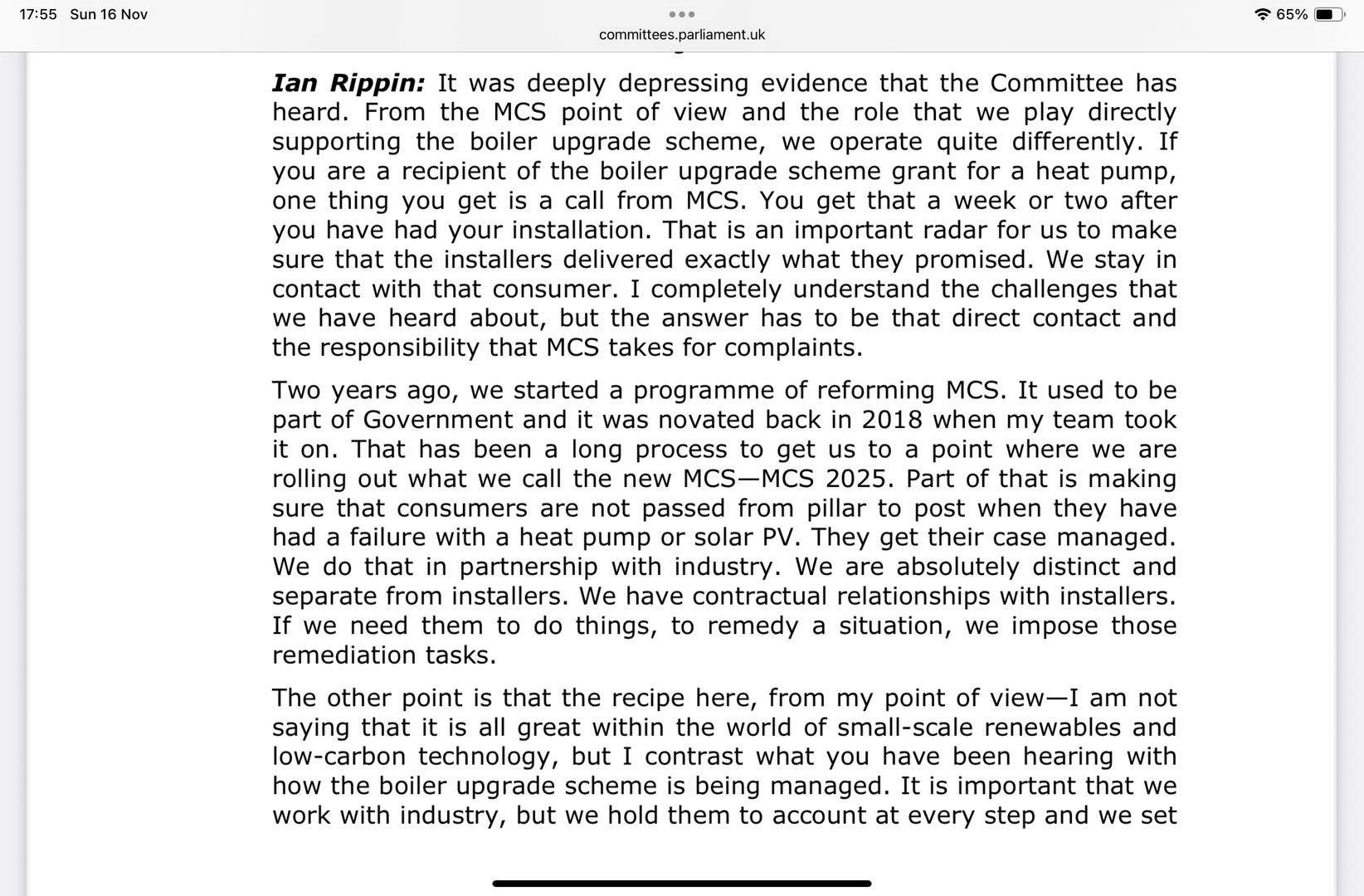

@editor contuning your theme of MCS. I started reading the audit committee investigation on the insulation scandal and Ian Rippon was explaining how good they were (possibly not quite as bad!)
But I had to stop reading at his sheer arrogance/ignorance/wilful self delusion/simply lying b*st*rd, was so annoying. I will read a little more but a letter to the chairman might be an idea.
 The question I was asked over the phone was are you happy with it, about a month after installation in a mild October.
This is why I was pleased a year after installation DESNZ offered me a much more in-depth questionnaire about fulfilling bill cost estimate,  warmup times, being warm enough last January, warmth expectations, did we run the pump continuously. All of which are the correct questions to ask, not just are you happy which will only capture the most upset people.
extract from page 22

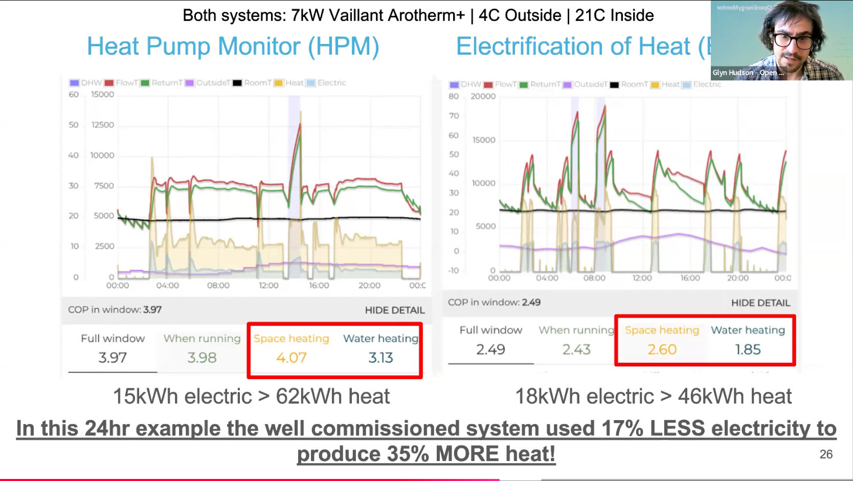

Look at this comparison between 2 identical Valent heat pumps operating under identical weather conditions (see video for details)

Great comparison.  Here is my analysis (I haven't listened to what Glyn says):
Given that this is at low OAT and looking at the FT behaviour, the second one is clearly well oversized and the system volume is hopelessly inadequate.  I am guessing that this is a 7kW heat pump in a 3kW house (with correspondingly few radiators so little system volume).  In addition either the cylinder in the second one has insufficient surface area, or the target DHW water temperature is set way too high (just look at the flow temp) - unless that is the second runs two legionella cycles within four hours of each other.  If this is the case then commissioning alone probably wont fix it entirely, the addition of a sizeable volumizer would probably help a lot, although really it should be downsized to the 5kW model.  Its possible that there is a buffer tank in which case that should be removed.  The DHW set temperature should be reduced to 48 ish, DHW set to eco mode and the legionella timings checked.
Another possible interpretation (less likely IMHO) is that the system is being operated with TRVs/zone valves most of which have shut down.  In this case it could just be a case of weather compensation curve too high and owner needs education in how to run a heat pump.  The cycling looks quite regular though, whereas if TRVs were opening and closing the cycles would presumably be less similar.  Anyway its easy to tell!.  That still wouldn't explain the DHW, for which the likely answer is the same as above.
The first one is right-sized and has a sensible DHW temp setting.  Its performing as expected for a competent install.
Im just an amateur though so what would I know?
