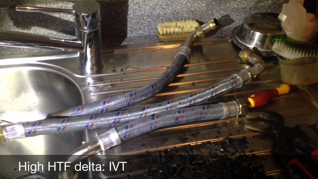

Both “Electrical cassette” and “High pressure switch” errors are happening several times a day. Acknowledging the error lets the heat pump continue, but clearly something is wrong. Previously I had problems with “High HTF Delta” that seemed to be this problem, which seemed to be fixed by changing the pipes.

Hi, are you able to see the delta between GT8 vs GT9 temps? If this is more than 10 degrees then it would suggest that there is a flow issue again. When you changed the hoses did you flush out the system, especially the heat exchanger? I had the same errors as well as high HTF before I changed out the hoses, does the electrical cassette trip out?

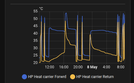

The temperature diff remains fairly low during operation.
I didn't do the hose change myself, but I know that the radiator circuit was flushed out.
And yes, the "electrical cassette" error, as well as the "high pressure switch" error happen and cause the heat pump to cut out. Acknowledging the error resets things and allows the heat pump to run again (until the next error). These errors are happening several times a day.
This only happens when running the hot water. The radiators are not problematical (not that they are on now). I seem to recall that the same happened last year - these problems started once the radiator heating was no longer needed.

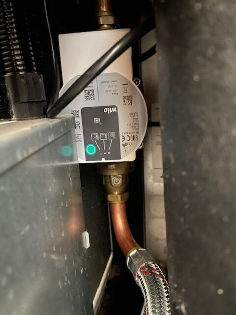

I know you will probably have tried this, but if the GT8/GT9 temp differential is low, it may not solve the issue? However, Pressure Switch High (HP) error indicates there is not enough flow over the heat pump. Check the heat carrier pump is working (it's the central heating type pump just to the left of the compressor), and try increasing the speed if it is. There is a switch on the pump, which has 3 settings, turn anti-clock to speed 3.

OK, so when the HP comes on it becomes obvious.
It's on the setting on the right (one one where the curves are curves, not straight lines).

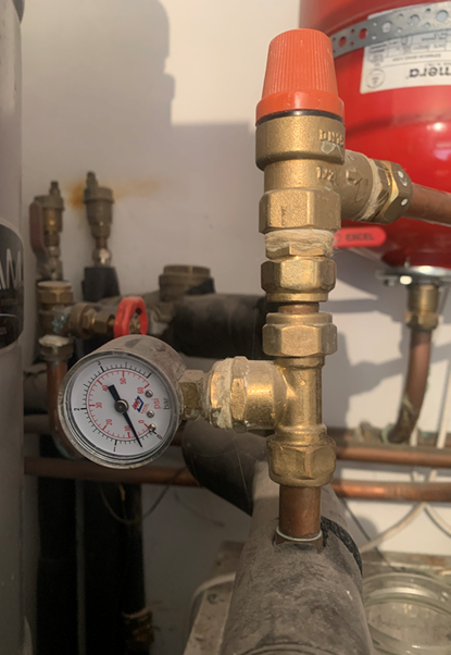

Hi, apologies for piggybacking on this thread. I also have a C11 IVT Greenline Heat pump. The company that I got to install it back in 2011 are no longer in business and I always find it difficult to get anyone to service the pump or even ask for advice on the pump. I am having an issue at the minute with low pressure registering on the pressure gauge at the top of the pump. It is currently sitting at around 1/2 a bar and I think it is supposed to be set between 1 and 2 bar. I noticed it low and let air out of the water tank by loosening the nut at the front. The air is all out but I noticed the gauge dropping even lower after doing this. I have no idea how to get the air pressure back up to the correct setting. Would anyone be able to advice how to reset the pressure. Thank you.
Posted by: @get. I noticed it low and let air out of the water tank by loosening the nut at the front. The air is all out but I noticed the gauge dropping even lower after doing this. I have no idea how to get the air pressure back up to the correct setting. Would anyone be able to advice how to reset the pressure. Thank you.
I know absolutely nothing about this unit but it sounds like either it needs topping up with water or the expansion vessel needs to be repressurised. Is the air from the heating side or the ground loop side?
Hi, thanks for the reply. The air is from the domestic hot water cylinder that is contained inside the heat pump.
