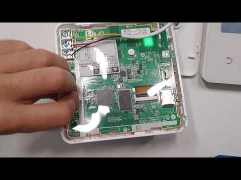

I saw this video regarding updates of LG AirCon PREMTB100. Controller appears to be same physically with different software?
Software updates are done with a MicroSD card.
I note ThermaV Controller has the same MicroSD slot.
Needs installer or someone with good contacts at LG to clarify whether an upgrade is possible on ThermaV of whether a physical replacement of new Controller is an upgrade route?
