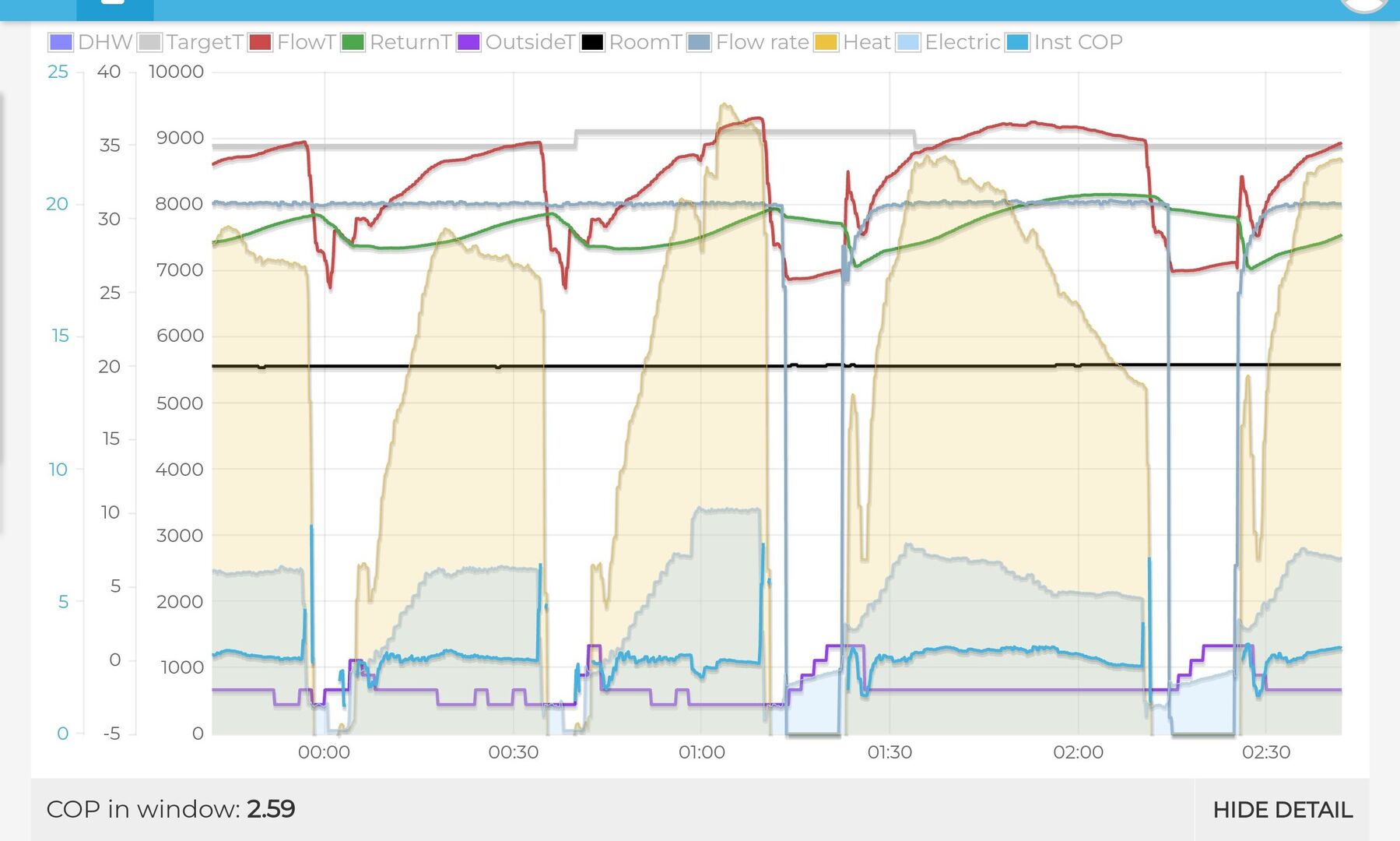

@robs   Regarding the November operation as attached, the DT is increased to 8C to get 9kW at the flow of 16 l/min with both compressors. Mitsubishi obviously set the flow at constant 16 l/min because that is rate for 6kW at 5C DT. Minimum output at 2kW shows a 3:1 ratio so this all stacks up. This blows my theory of manually turning down the flow out of the water. The defrost cycles are clear with electrical energy used in the dips.
RobS Nov
For the previous January graph, the dips at the reduced flow level to the right show that there is no electrical energy used in the dip. This suggests that this is normal cycling, not defrost cycles?
The only thing that puzzles me is that your reported room temperatures over the heating season vary in the range 16C-23C. This wouldn’t work for me. Is there any reason for this?
The flow rate isnt controlled by Mitsubishi, the installers said 16-20 l/min was fine. Experimenting I've found 16 l/min to be a good balance, as you say 5C dT at 6kW and 8C at 8+kW.
Posted by: @heatgeek
The image below shows the two types of defrost side-by-side, two reverse cycle ones on the left and two hot gas ones on the right. The reverse cycle ones do use electricity, about 450w for 3-4 mins. The flow temp dips below there return temp in both (more on that below). The image also has the OAT measured by the heat pump, rather than the Met Office, and so shows the rise in localised OAT when doing a defrost.
2025 04 15 21.45.45 192.168.0.61 d61ae180 7a72 4750 8583 b9941a4ef4c9 1
This discussion prompted me to zoom right in to a dual compressor defrost and it looks like it does the first part of a regular reverse cycle defrost before doing a hot gas defrost (I'm assuming that's what the 700-800w electrical use for 6-7mins is based on the compressor specs). So the house does lose some heat but noticeably less as the water pump runs for a shorter period during the defrost cycle.
