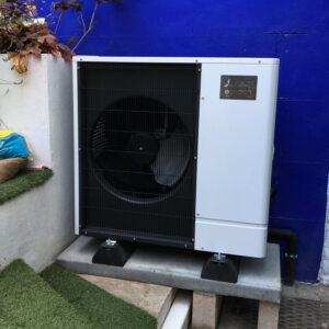

Hello, I'm looking at air source heat pumps as I need to replace my boiler and looking at ways to reduce environmental impact. I live in a 100 year old terraced house in central Scotland, so walls are solid stone, not huge amounts of light or warmth from sun available, and neighbours are close by. With wall insulation and upgrading pipes, an ASHP might be possible.
- There is room out back to set up a unit (next to the wall on the right, in picture below) and my research so far has reassured me that running noise won't be an issue from within the houses - but with the gardens being small, I'm concerned that the noise could significantly impact our enjoyment of our outdoor space, for us and our neighbours. There's no front garden so this would be the only possible location; also, vertical ground source is out as there's no access for drilling equipment.
Has anyone installed an ASHP to a terraced house like this? Or can otherwise comment on quieter models? I'm assuming that it's going to be quieter during months we don't use central heating - about 6 months over summer we don't need to turn it on, but do use hot water.
I've searched for videos that attempt to demonstrate the noise levels but it's so difficult with sound recording. I think to make a decision for major work like this we probably need to see one operating in real life but that also seems difficult at the moment.

As you say the ASHP won't be doing much in the warmer months when you are likely to be sitting out. And, you'll get a nice cold air blast if it does come on!! How far is it from the wall to the fence? It looks like you could fit one in the space you have; it needs to be at least 1m from the boundary to be classed as permitted development (I assume Scotland is the same as England but don't know) and also needs space for air to circulate. It'll have to be 300mm from the wall and they tend to be 3-400mm deep.
They really aren't noisy when compared with all the other outdoor sounds but it's a matter of opinion and you'd have to hear one yourself if you're concerned. When you and your neighbours are sat at your tables you're not going to hear much.
@shadowterrace, @kev-m is correct. Over late spring, summer and early autumn, the heat pump is not on very often, and when it is, it's not running on max. The thing, is if it's cold enough for the pump to be on, you probably won't be sitting in the garden. Having said that, the noise can be annoying if you are outside and braving chilly weather to enjoy your time outside, so it's best to try and find a pump that operates at less than 40dB. Our heat pump, at max speed, is over 60dB, and is clearly audible at 5-10 metres away if you're facing the fan.
Having looked at your garden, I would suggest you identity a pump you think would be good for your property and see what the published noise levels are - then find something that emits a sound/noise at around that level (a hair dryer at a lower speed, perhaps) and see if you can "live" with it.

Hi @kev-m thanks for the welcome! Good to know the space requirements. We're planning to put a narrow storage shed on the left of that space, so we'll need to ensure there is room for passage through - and airflow of course. It's a 3m wide space, the shed will take up 1m of that, and from your estimates about 0.7m required for the ASHP unit, so the remaining 1.3m will hopefully be a reasonable gap for air flow.

We’ve just had the Daikin Altherma 3H HT unit fitted. It is quiet. I will try and record. But only have a iPhone microphone 🎤
As with any ASHP, there is an icy blast when the unit is running. But as stated elsewhere, not really running it in the summer, when you are sat outside.
But you need a home assessment. An EPC rating. And a room by room heat loss and heat demand assessment before you decide whether an ASHP is right for you. And then which solution.
My Daikin is less than the planning permission 0.6m3 unit volume. And 18kW. So powerful. But your building assessment will define the size of system you require to keep your property warm in the depth of winter.
You also need to be 1m from your neighbours property boundary which could impact your design. Check local planning regulation.

One thing that you need to look into seriously is the airflow around an ASHP. If there is any possibility of the cold air coming out of the ASHP being drawn back into the inlet, then you could have serious problems with both efficiency and noise levels.
Totally agree Derek. The ASHP needs to “breath” and be free

@derek-m that makes sense - so efficiency affects noise, and in turn, airflow affects efficiency. Perhaps this is an argument for mounting the unit higher up on the wall; although that makes it less accessible for maintenance.
The garden is sort of boxed in by the higher walls, and of course the two storey house. There's no wall space to mount the unit on the end of the building (because windows, and sloping roof) so the only possible location is on the side of the kitchen/bathroom block shown in the photo.
Higher up on the wall, above the height of the walled area, might be breezier than down below.
I'm also starting to wonder what effect the fan will have on nearby plants and bird-feeding stations; so a higher up location could interfere less with the stability of the ground climate.

The units are very heavy, so you would need to check about wall mounting.
Your starting point should be to improve the insulation and air-tightness of your property, since this will impact both the size of unit required and running costs. It will also have an effect on efficiency, since you should be able to operate at lower water flow temperatures.
Since it was installed Wednesday (Earth Day 😊) it’s been warm and sunny, so the Daikin hasn’t really run. I have a decibel meter on my iPhone so will try and take a reading at 1m and 3m. In front. And to the side. When it was running, I would describe it as a low hum. I can’t hear the compressor - 56 years young. So will ask my 21 year old daughter if she can hear any high pitched noises.
