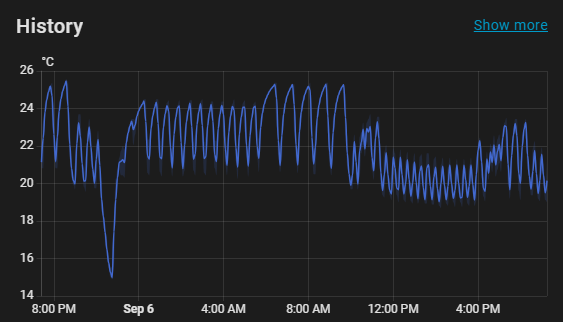

Hello, I have a Inventor (Midea) 8kW with a 800meters Φ10 pipes under-floor heating system of total ~50L water volume (there is also a magnetic filter and an electronic vavle to switch between dosmetic waters boiler and the ufh. No extra expansion vessel (just the HP's) no extra circulation pump (just HP's internal). Currently, in COOL mode (Greece 😀 )
At manifold I have the "glass things" turned full for max flow (pump after 5-6 mins run shows 1.52m³/h). I have tried everything water temp target for start/stop (T1), thermostat for start/stop (with cooling curve for water T1S C1 to 18C) but it always the pump will cool the water very much under the water temp target T1 which fire the stop or the T1S C1 temp (so thermostat is still on but compressor stops) which results in compressor running only for 5-17mins TW_O goes 17 and TW_I 20 or 21 (ΔΤ 3-4) and pump stop since it drops under the 18C even though room temp is 27 and the thermostat set temp is 24.
It supposed the heat pump's inverter would kick in and instead of overshooting to 17C temp it should slow down (decrease Watts) and run the TW_O close to 18.XC but not lower than that. I have also tried to power limit it (Midea advanced users know) to step 5 which reduce Ampers to 12 but still nothing heat pump will cooldown the TW_O below the water temp target and make the heat pump stop for 5 mins.
Only time it ran more than 20 mins was when I set water temp to 12C and it dropped the water temp to 15C and stop it to avoid develop water all over the house xD.

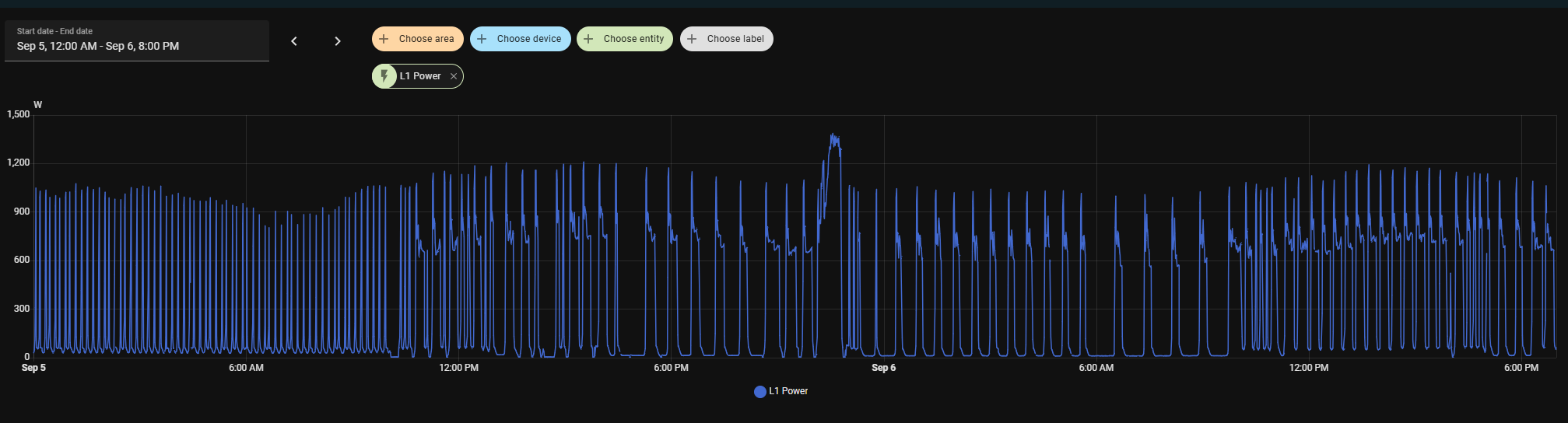

Below is the power consumption of the heat pump which shows the short-cycling
Your short cycling is occurring because the heat pump can't modulate down enough to match the demand.
If you increase the system volume as suggested it still won't be able to modulate low enough but the cycles will get longer and less frequent, which is desirable.

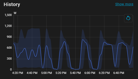

I've also tried the power limitation with no luck (maybe when I add the extra 80L might work) I see compressor amp 4 when it start the circle, 3A-2A afterwards (probably trying to modulate)

Heating is working better xD I have 2-4kWh consumption per day. the Cooling is that hitting 10-12kWh per day and I want to fix this (it short-cycling every 10-16 mins)

Heat pump short-circling also on winter (HEAT mode) but need to work much less times in a day so that's why the low daily comsuption.

I used 15C to increase the load as you mentioned together with power limit and currently it modulates ? 😀 (outside it's 32C)
I installed the 80L tank (volumizer) things got better but still...
I installed an external circulation pump (it's 1 hydralic system tank in series) in increase the flow rate and reduce the ΔΤ probably improved more but still Heat pump cycling a lot Although now was working 40-50mins
A curiosity to know what temp is the water in the tank made me to order and install Tbt1 sensor into the tank. As soon as I enabled the Heat pump is now stopping based on the water temp in the tank not the TW_O (T1) outlet water of the Heat Pump. So now if I ask for 28C (heating) DTSC 2Κ the pump will have TW_O (T1) 32-33C without stopping not until the tank temp (Tbt1) goes 30C. Althought from what I understand I should have install buffer (with coil) instead of volumizer in onder to create 2 separate hydralic systems.
Now I have 2-3 hours long cycles ~ 4-6 cycles per day. The key was installing and enabling in the settings the Tbt1 sensor
