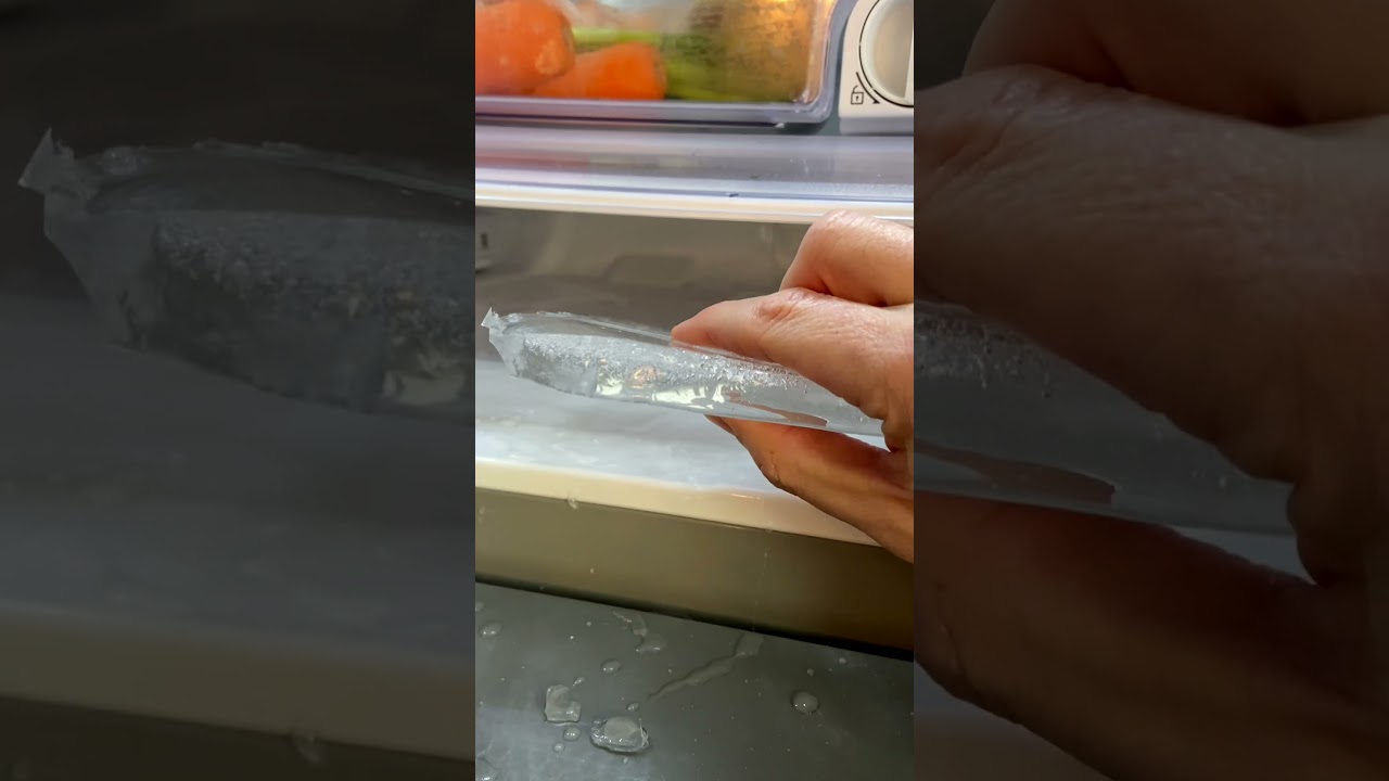

That is a lot of ice! Has the heating element in the freezer packed up? It sounds counter intuitive and I was surprised to find out that it had one. I too have had a Samsung fridge freezer with ice maker for many years and the only issue I have had was the heating element in the freezer gave up causing it to ice up severely. Replaced by a local engineer for £30 and no further issues.
@editor This model only has one compressor, cost saving, to do fridge and freezer; but it was touted as frost free, likely for the freezer only 🙂
The one i had turned the fridge into a freezer every year. It was a simple fix to remove the lower back panel in the fridge, there is a condenser behind it that would ice up if the drain holes got blocked. There is a temp sensor on that pipework but it likely wasn't doing a good job.
Good excuse to empty the fridge and deep clean it every winter
Had the FridgeFreezer for 13 years till the compressor started clonking; bearings were worn out.
@abernyte We’ve spent a small fortune on engineer call-outs for this fridge. Early on, we even had a major component replaced (details here). The ice maker is a mess… it constantly looks like a cave full of stalactites, and there’s clearly water leaking down from somewhere that end up beneath the fridge tray and the freezes. It’s an appallingly designed appliance, and Samsung’s customer service has been equally terrible, as we’ve outlined in the post. Will never buy anything Samsung again.
