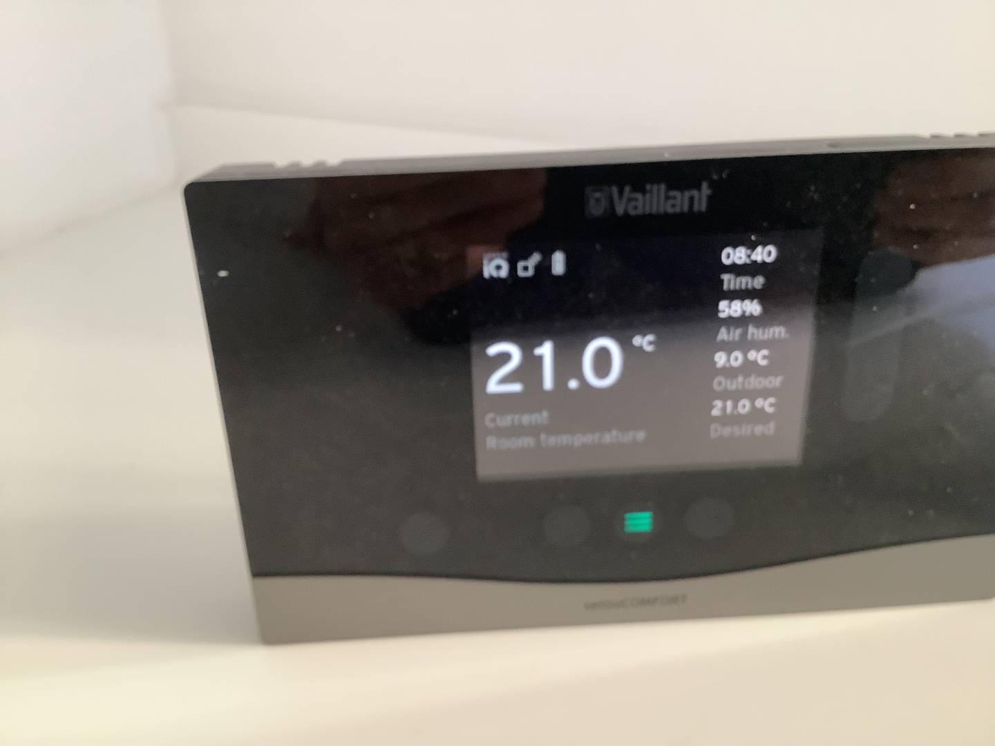

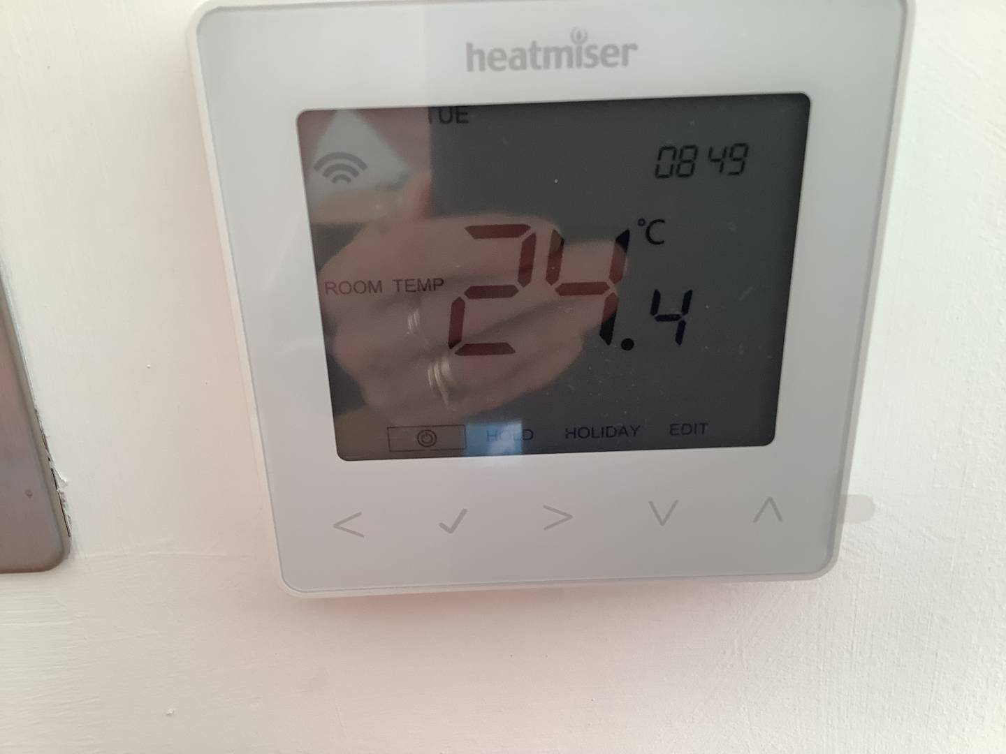

Posts: 10
@derek-m The ASHP control has one heat zone only.  I reduced the desired temp on that last night by one degree to 21. No change yet but I understand it takes 24 hours. The thermostats are still showing between 24 degrees (where set for 18) and 21 degrees (where set for 20). Meanwhile, it looks as if the valve on the ufh control for the master bedroom is open (the top of the valve is raised a few mms but the red indicator remains unchanged).

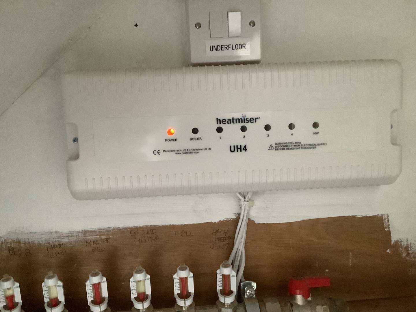

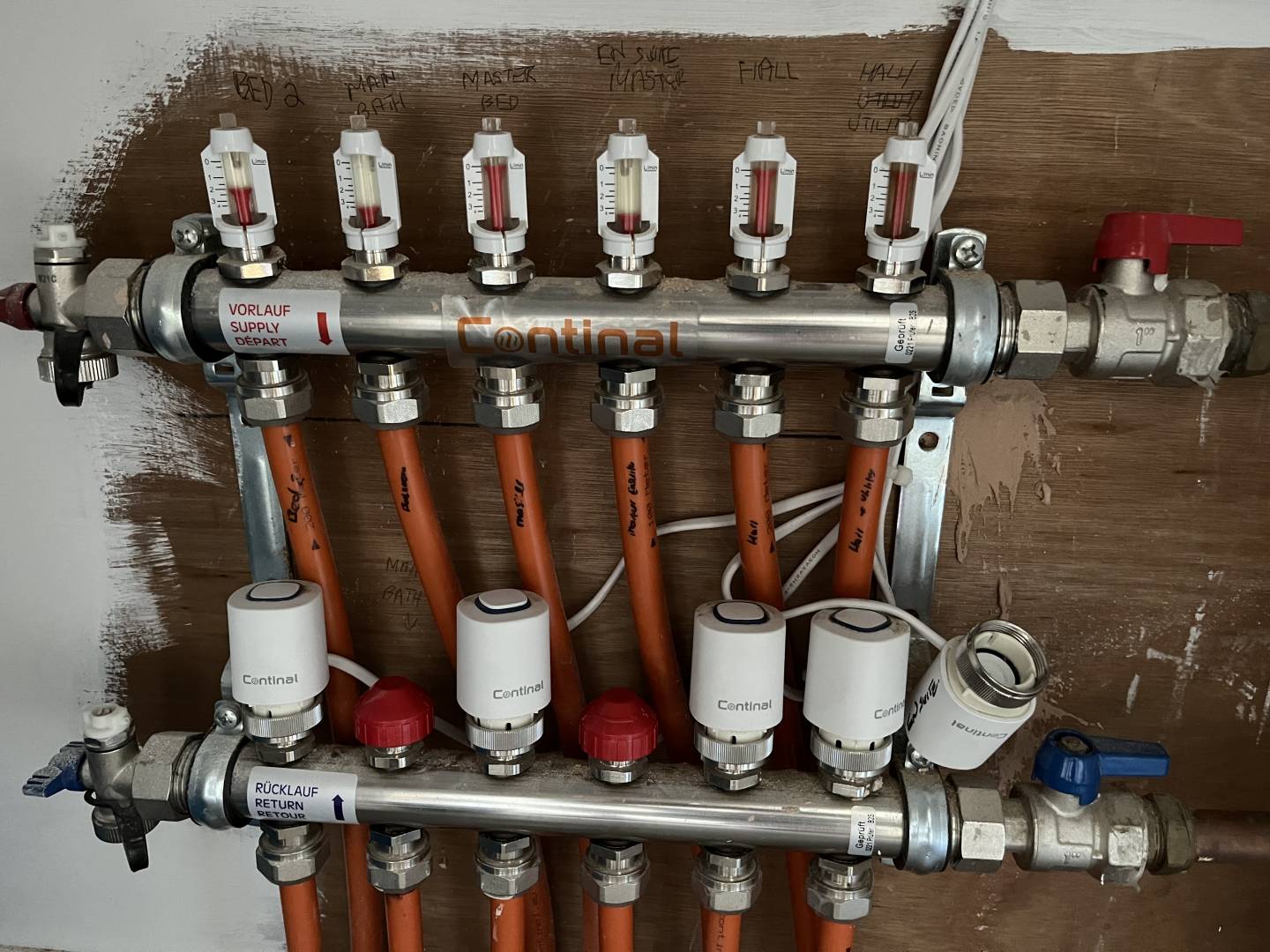

Can you please provide closeup photo's of your heatmiser controllers and your heat pump controller.
(@emmajg)
Posts: 10
IMG 3893
IMG 0903
IMG 0902

@emmajg
Can you provide a photo of the unit(s) to which the wires from the solenoids are connected.
How many water pumps do you have on your system?

(@derek-m)
Illustrious Member Member
Posts: 4425
Posted by: @emmajg
IMG 0904
Thanks Emma,
So you have a small system with 6 UFH loops, two of which are permanently forced on by the red caps on the valves.
When you operate the heatmiser thermostat, do any of the LED's on the main unit come on, if so which?
Does the heat pump start and stop when the heatmiser thermostat is operated?

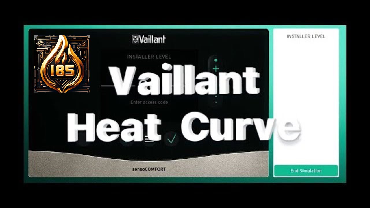

@emmajg
Do you know the settings of the weather compensation curve on the Vaillant controller?
The following video may help.
