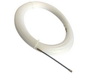

If that all fails, then buy a 30m-long nylon cable draw-tape from Screwfix (or similar outlet)
The dark bendy end goes in first.
That leaves you with a brass eyelet to which you attach the new cable.
