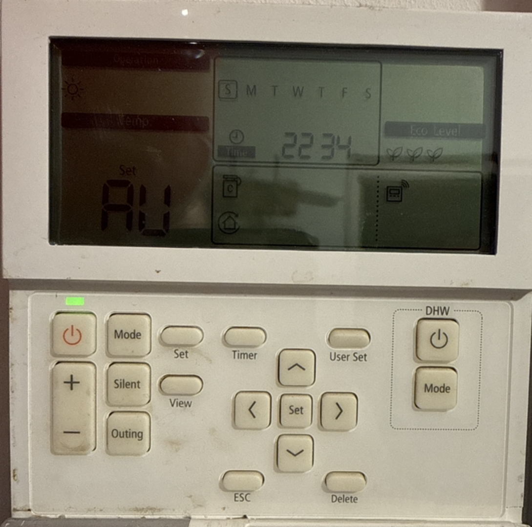

I have a Samsung MIM-E03 16kwh heat pump, and really struggling to get any useful data out of it.
I'm specifically looking for the flow temperature and the return temperatures. All my controller seems to display is the "Discharge Water Temperature" when I cycle through with the View button.
I'm running on AU / Water Law mode, and I can see the discharge temp with the UFH on, is reaching about 44 degrees. I'm hoping this isn't the actual flow temp as it seems way to high?
Reason for checking this is power usage seems to always be 3-4.5kwh when heating is on - I just want to check the flow temp isn't wrong or stopping it modulating maybe. Or maybe this is just to be expected 🙁
Anyone know how I can find more useful data here?
Thank you!
