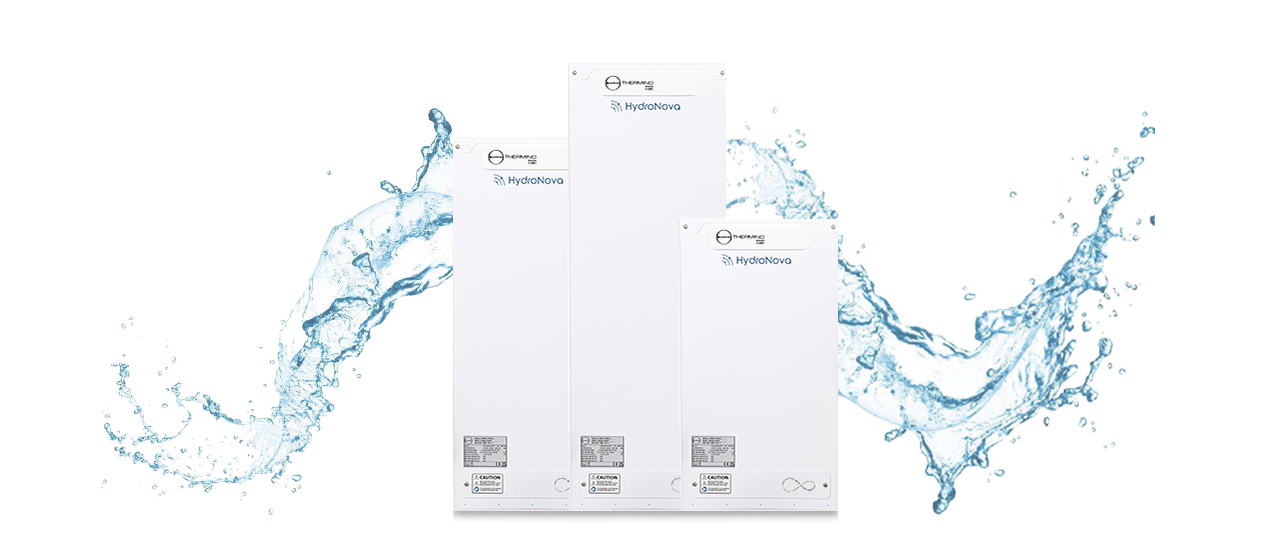

Sorry I was probably being vague but I was thinking out loud along the lines of something like this. I guess it was knee jerk to thinking I could run two heating systems (think I'd had a beer at the time so wasn't thinking!) 1. Just for hot waterĀ and 2. For heating alone as the heat pump won't deliver heat whilst it's heating the water. I think I've answered the question myself by just getting a solar diverter.
I've put the articles on anyway just out of interest, although again it probably more orientated to Australia!
https://www.herschel-infrared.co.uk/hot-water-heating/
In relation to this article where they are saying electric water heaters may be better at storing energy versus a battery used to heat the water in a cylinder.Ā
