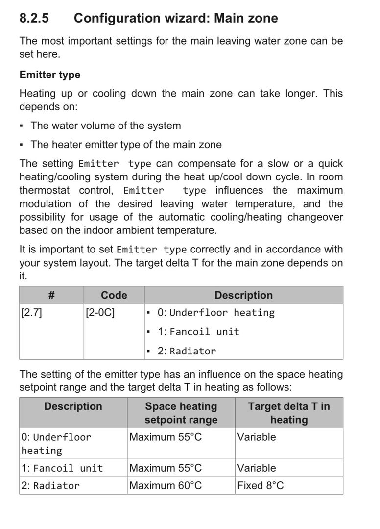

@editor Searching for anything in the Daikin Installation Manual is fraught with difficulties but I did find this:
Mine was commissioned running at DT5 and still is with Homely control. Toodles.
And there is information in a Heat Geek presentation on setting up a Daikin Pump using the MMI; the suggestion there is to use Fancoil setting - even for radiators.

Posted by: @editor@rhh1, got a reply from Daikin. There brand manager was way on holiday. He's replied saying, "The delta of 10 for the radiators applies to all our air to water heat pumps. Please let me know if you require more info on this."
