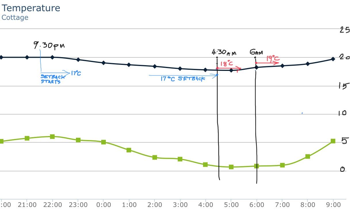

Here is an update of the setback we operate on our system.
We have created a simple schedule which copes with different night time outside temperatures. This is worth considering because if the outside temperature is particularly cold the indoor temperature will also drop lower than you might expect. So this means the morning reheat would need to start earlier in the morning to achieve a comfortable room temperature by a targeted time in the morning.
the attached graph shows the times our schedule changes and the degree of setback. The room temperature line is the black line and in this illustration the room temperature doesn’t drop to 17C. But the temperature is below 18C at 4.30am so the HP will,start to heat at 4.30am.
IMG 0329
Conversely,  if the night time temperature was above 18C there needs to be an automated way, built into the schedule, to delay the start of the reheat of the house. This means you are not wasting energy bringing on the heating too early. So in a milder night the heating would be delayed until 6am which is the next scheduled start targeting 19C.
The heating on our system operates in weather compensation mode which would typically overshoot the target temperature by 1C before switching into standby mode. However our weather curve is set to operate at a gentle output and only slowly attains 20C in about 3 hours.
We usually manually adjust the temperature up to 20C or 21C around mid afternoon.
This works for us in our particular house but I think it’s fair to say differences in property characteristics, insulation influences and Heat Pump performance will vary from one property to another.

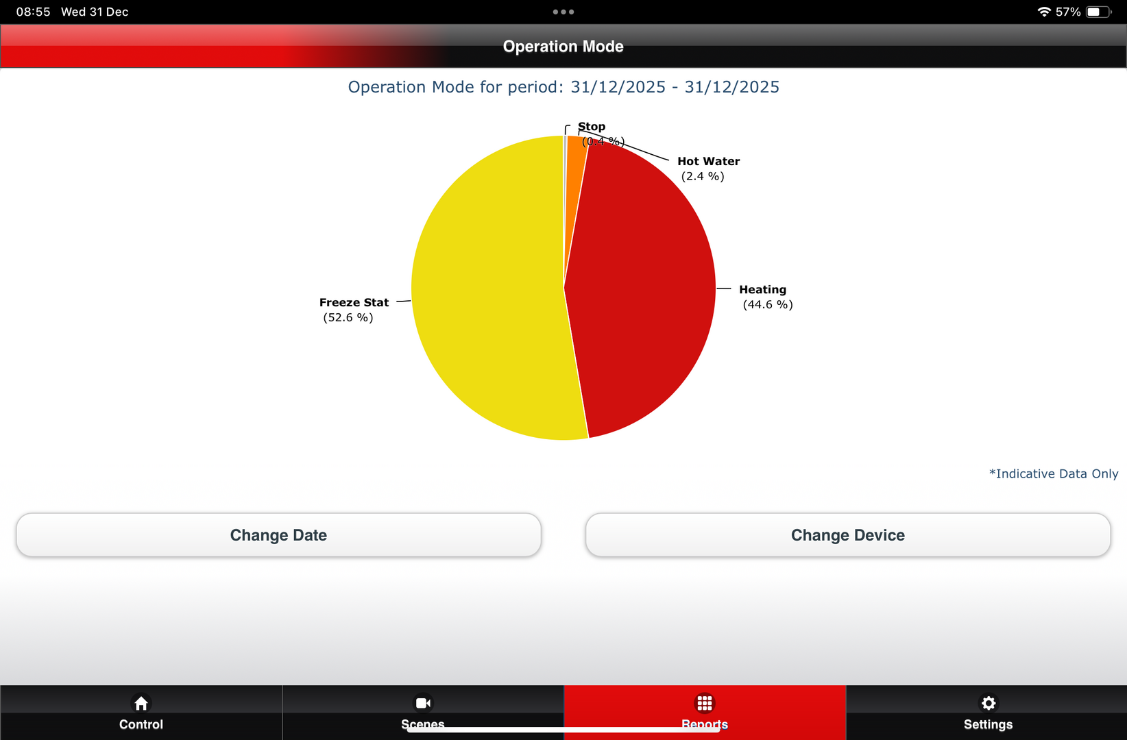

Perhaps the attached pie chart helps to show how energy can be saved during a setback. The yellow section shows how much time the HP was in freeze stat mode (in this case only activating the circulation pump to prevent the outside piped water dropping below 15C) it did this to protect the system for 4.5 hours. The red portion of the pie chart shows the heating when it was switched on at 4.30 am and  operating for the next 5 hours until the graph was created.
I hope some people will find this useful.

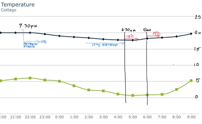

IMG 0329
