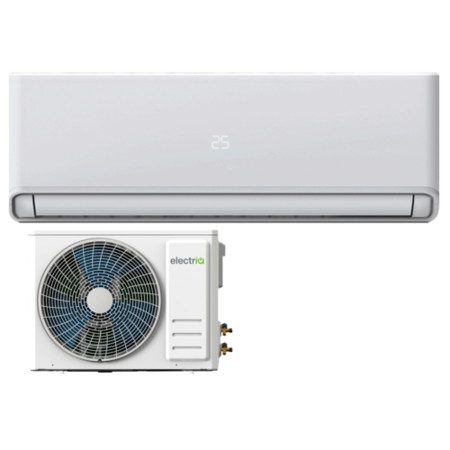

Hi Bob,
Here is something that I have been looking at as an alternative to Air to Water ASHP and the RHI/Green Home Grant route. Two or three of these sited around the house could utilise your solar output and reduce your oil consumption. You would not get any RHI, but who cares at this price.
You also get the added bonus of Air Conditioning on the odd day or two in the Summer when you may need it.

Air to Air heat pumps are viable and many people have them. From LG you can get a Multi system that consists of one outdoor unit plus up to five indoor units. There are bigger systems available but with increased costrs.
The choices of fan coils are wide and varied and its quite quick to install. You also get the benefit of air conditioning in the Summer.
This is useful if you have got a relatively new boiler system. It is also quicker to heat up the space.
