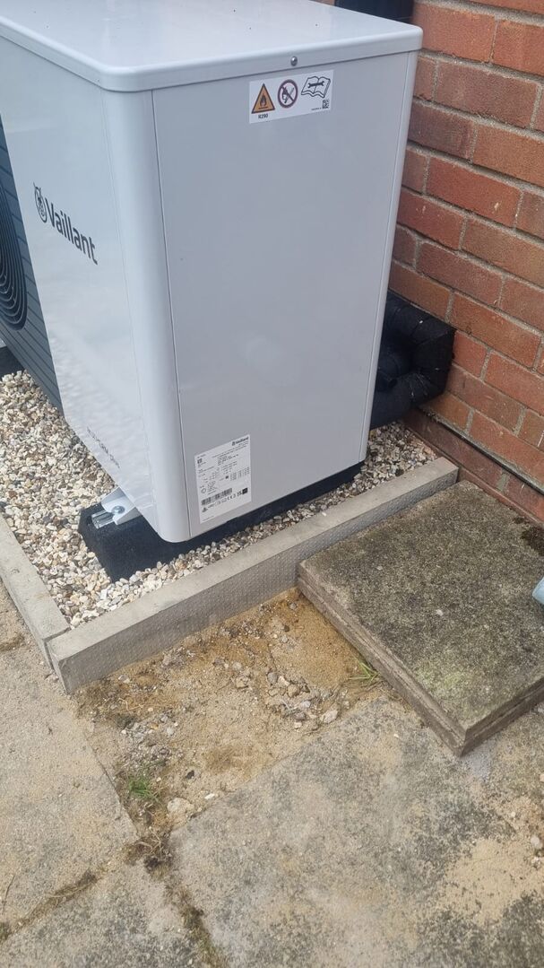

Right now I am questioning if I should ask them to come back to cut and fix the two slabs I asked them to leave so that it would make my life easier not to do this job on my own, but I am not sure if I have the right to ask for it (picture attached).

Posted by: @eliuccioRight now I am questioning if I should ask them to come back to cut and fix the two slabs I asked them to leave so that it would make my life easier not to do this job on my own, but I am not sure if I have the right to ask for it (picture attached).
Personally i would say this is reinstatement which they should have done, but there is room for argument depending on the precise words of the contract. You need an angle grinder to cut the slabs, if they have one and you don't I would try to persuade them to do it!

I will ask them why they are not and will also try to persuade them
