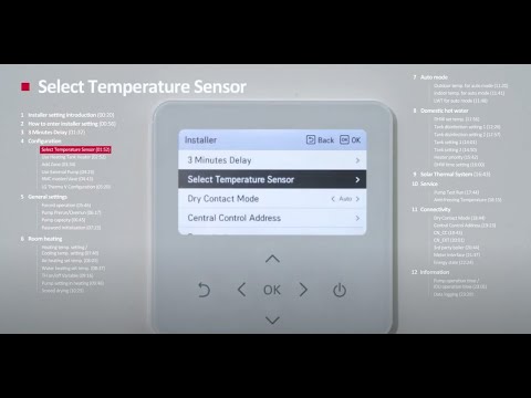

Hi Harry,
You may find the attached video of interest, since the LG controller can accommodate the inclusion of solar thermal.
