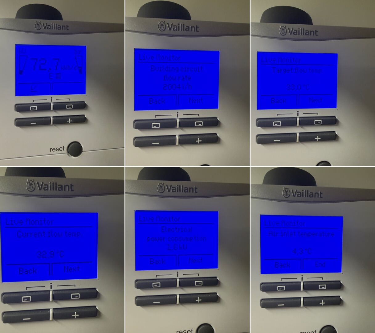

So 19 hours later my efficiency for today is at 3.94 and pics below of the rest and most importantly house is feeling good for now.
Screenshot 2025 11 25 at 10.57.27
at 11:00: target 33c, current 32.9c, 1.6kW, 4.3c
Image 4
Now to see how we go when the temp drops, from 00:00 to 11:00 total power consumption for heating is 20.6kw so prob looking at 40kw and we are not in the cold cold yet.

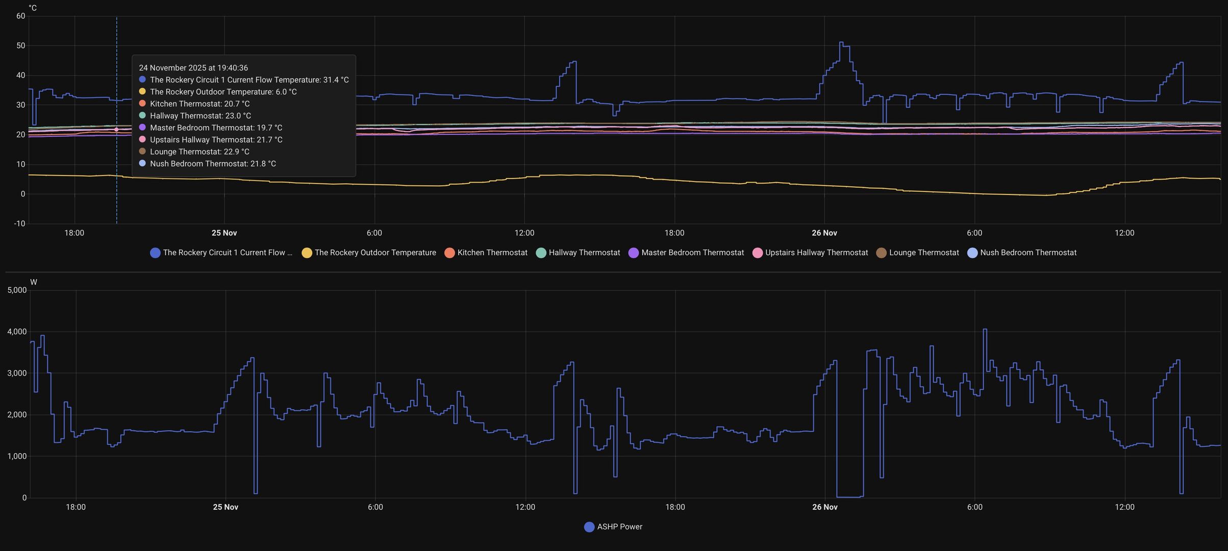

UPDATE: Very happy wife, since 24*7 I've actually had to move the heat curve down to 0.4 as you can see from the charts the temps are staying pretty stable, even overnight drop to 0/-1 no issues at all, will keep running but honestly I think I may still be able to drop (surprising)
Screenshot 2025 11 26 at 15.50.24
13.6kw Solar, 40kw Battery, 10kw Heat Pump and EV Cars

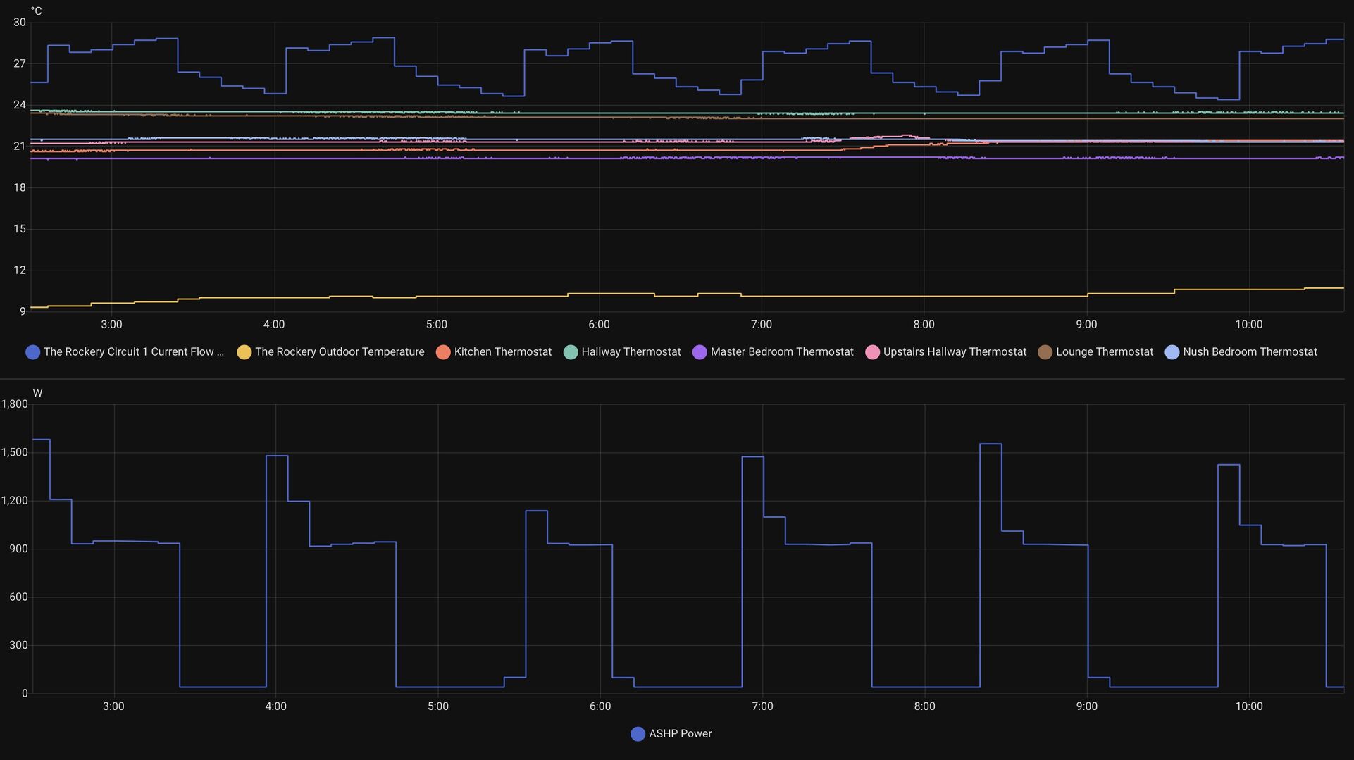

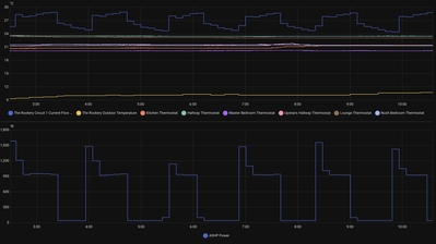

With the changing temperatures, I've run into a new problem that I thought I would never have, so yesterday while temps were super low, my wife for the first time in her life said its actually too warm in the house, she reached her dream temperatures but then realised its too much and too stuffy.  I started running at 0.3 curve and temps are all fine.  But the new issue is overnight and today the outside temp went up its been 10c since the morning.
The heat pump is now cycling because the demand is so low it is overshooting and then switching off, personally I have no issues with this assuming its not bad for the heat pump and i know once the temp drops it would return to its long running which will be in a few days i guess.  Is it ok to leave it running this way? When outside temp is 8 and above I need very little heat to replace the loss. I'm not sure how to leave it running when outside temp rises, and would be nice not to constantly have to change.
Screenshot 2025 11 27 at 10.35.00
