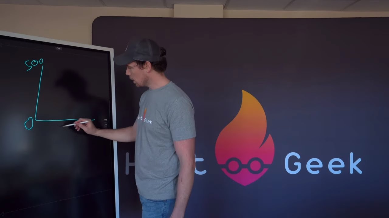

Here’s is an interesting training video from Adam (Heatgeek) targeting a discussion to the would-be plumber re- training brigade. Try viewing from 3mins onwards but esp. 3.57 onwards. For the discussion on smaller heat pumps as opposed to larger heat pumps.?.?
It is 2 years old but shows the targeting of the plumbing industry on how to future proof their businesses and careers. Any thoughts?
