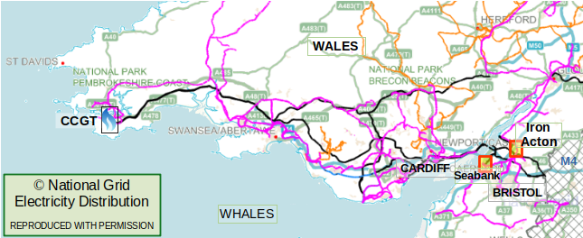

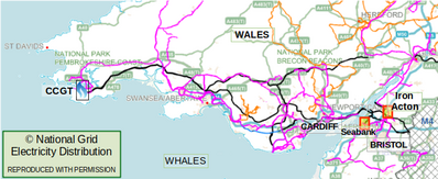

That northern part of Bristol is substantially powered from the Combined Cycle Gas Turbine (CCGT) plant at Pembroke Docks.
IronActon
Electricity from there goes to the major Grid Supply Point at Acton Gate, in the constituency of Thornbury and Yate,
where the newly-elected MP is Claire Young - now a Member of the Commons Select Committee on Energy.
If you're one of her constituents, please feel free to copy this to her!
