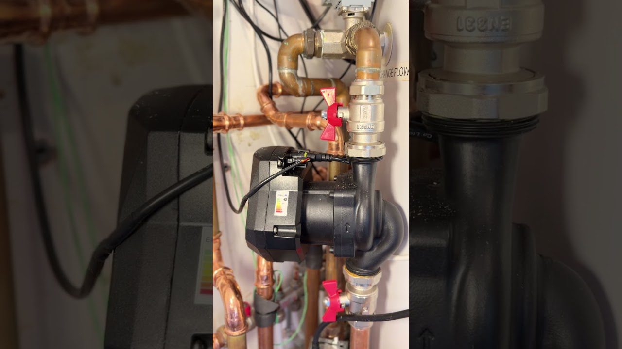

Recently, during pipework alterations on our buffer tank and central heating system, our installer removed ours. We asked him to reinstate it. He refused, insisting we did not need one. Against our better judgement, we let it slide.
The consequences were immediate and, frankly, disastrous. The system had been drained, flushed and refilled, and we strongly suspect that the underfloor heating circuits had also been emptied. A new pump was installed. Once everything was re-pressurised and switched on, the system was awash with air. The sound was intolerable.
Each time the pump started, the noise of bubbles and air being whipped through the pipework was enough to stop conversation. It sounded like an industrial kettle boiling itself inside-out. Watch the short video below.
For days this continued. The installer said this was normal and that we should just keep bleeding radiators repeatedly, and only on the very first attempt did any significant air escape. Every effort thereafter produced nothing, yet the system is filled with air. The installer had no solutions. He fiddled with unions, sprayed water around the utility cupboard in the process, and then shrugged. His advice was to keep bleeding radiators for a few weeks and wait for the problem to resolve itself. It did not.
This is the crux of the matter: in any heating system, but especially in modern low-temperature heat pump systems, air is not an inconvenience, it is a systemic threat. It reduces efficiency because circulation is impeded. It reduces heat transfer because radiators and underfloor loops cannot emit what they are meant to emit when pockets of gas stand in the way. It accelerates corrosion because oxygen is now present in the very medium that is supposed to be protecting the steel and copper of your system. Most dangerously, it damages pumps through cavitation.
Cavitation is not a word most homeowners know, but it ought to worry them. When a pump operates in the presence of air and fluctuating pressure, gases come out of solution, forming vapour bubbles. When these collapse, they do so violently enough to pit and scar metal. Over time, cavitation will destroy a pump, and with it the very heart of the system. This is not abstract theory: it is visible, measurable damage and once it starts it cannot be undone.

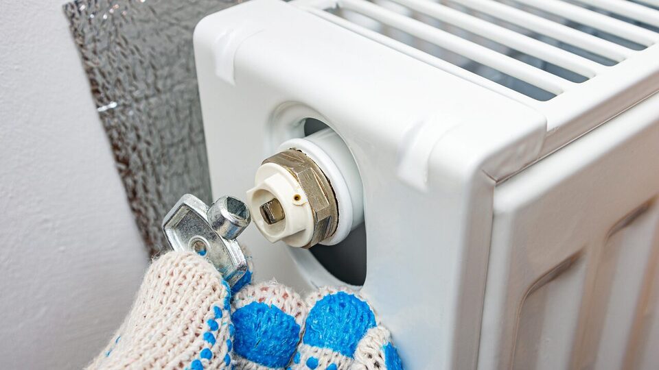

Nevertheless there was one tall radiator which needed manual bleeding every day for about a month as dissolved air, which could not have been purged by the installer, came out of solution.  Im guessing most of the dissolved air ended up being vented by the air release valve, but the local ‘high’ represented by the radiator remained a trap for small bubbles which the flow through the radiator didn’t sweep away.

FWIW, nearly a year after my heat pump install, I bled a radiator today and probably a third of it was filled with air.  I do have an autovent fitted at a sensible place, but they cant guarantee that air wont collect elsewhere if there are other local ‘high’ points.  The rad in question is a towel rail and extends about 1.5m above the floor.  My wife alerted me to the fact it needed bleeding.
So even if you do fit autovents you are not immune to air collecting in the system.
