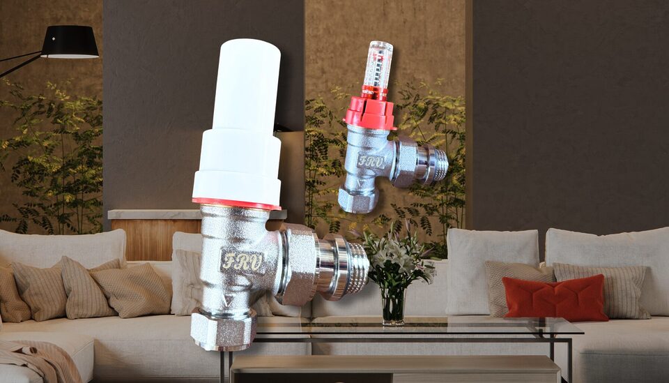

This is where a new product comes in that’s turning heads among heating pros: the Flow Regulating Valve, or FRV for short.
At first glance, the FRV is deceptively simple. It replaces your radiator’s standard lockshield valve, but unlike the old-school version, it lets you quickly and precisely set and check the exact flow rate for each radiator.
No more guesswork with screwdrivers and temperature probes. No more vague instructions about “turning it a quarter turn and hoping for the best.” With the FRV, you fit the valve, consult the simple flow rate chart to find the right setting for that radiator, adjust the dial to the correct flow rate, and you’re done.
The clear visual indicator shows you exactly what’s happening inside. Once set, the valve holds the flow steady, ensuring each radiator gets exactly the right share of heat, all the time.
You can still use TRVs (thermostatic radiator valves) at the other end if you want extra room-by-room control which is handy in rooms with big windows or unpredictable heat gains. But the real magic is that the balancing is now built into the system by design, not left to chance.

Great video again this week @Mars, I am very interested in the FRV valves referenced in the part about balancing. I had a disastrous attempt at balancing my rads last time around and basically gave up and just opened them all up again. I got the rads to all be about DT5 but the next day after I headed of to work the system went crazy and sounded like it was going to explode, leading to a severe bollocking from the missus who had to deal with it. Note self never ever tinker with the system unless you are around to fix it lol!
@Grantmethestrength
There are a couple of subtle points to make here which might explain the noise you experienced:
1: did you ensure that, when you balanced them, the LSV on at least one radiator (normally the one furthest from the heat source, but maybe also a couple of adjacent ones) was fully open (and yet still in balance).
2: Balancing for DT5 is a mistake unless the design is perfect (which it almost certainly isnt) and the OAT is the design OAT and has been for at least 24 hrs (which is rarely if ever the case).
Getting wither of these wrong will lead, in most cases, to turning the LSVs down too far and thus throttling the flow unnecessarily, increasing noise and wear on the water pump and increasing running costs.
The objective is just to achieve ‘balance’ ie either the same DT (not necessarily 5, in many cases it will be less) across each radiator or the same room temperature (or the desired difference in room temperature) in each room, whilst keeping the valves as open as possible so as not to restrict flow more than is necessary.  Hence why you should start with and maintain at least one LSV fully open and not worry about adjusting the LSVs for DT5 (if, for some reason, you want to adjust for DT5 then its the water pump speed that should be changed).

When adjusting the FRV you need to use the area of the radiator. Does the radiator type (K1, K2, K3 etc) need to be taken into account?
Good question.  Based on physics I think the short answer is yes.
I have actually been thinking about this area since I posted above with the comment that balancing for DT and balancing for equal flow rate will achieve the same result.
I now think I was wrong and your question has cemented my belief that Im wrong.  If you balance flow rate per unit output it will result in equal deltaT.  The output for any particular rad type is proportional to area, but the proportionality constant is different depending on the radiator type (K1, K2, K3, K+)
I just looked at the FRV data sheet and it says to multiply by the area, but doesn’t specify the radiator type.  Something isn’t right!
@Mars I think you are in contact with these guys, maybe you know?
Grantmethestrength
@JamesPa that is quite important. It would be good if they had a video tutorial on how to set them up, with some examples of the maths for us dummies! I wonder if you would put one on the rad that is supposed to be fully open?
With their balancing process Im pretty sure all rads could end up being restricted at least a bit.  Its unlikely however that the restriction would be so great as to cause a problem.  Personally I would probably adopt a slightly different process but the difference would be marginal.
Doing some maths on their figures 1.3l/min/sqm at DT5 is 1.3*5*4200/60 = 455W/sq m (assuming water not glycol).
At room DeltaT of 20 thats equivalent to (20/50)^1.3 =1496W/sqm at room DeltaT of 50 (which is how rads are normally quoted).
Stelrad Type 11 500mm high rads are quoted as 1548W/sq m at room DeltaT50, so it seems that the figures in the FRV leaflet are for Type 11.
The Stelrad figures for other variants, and the ratio relative to type 11, are
Type – W/sqm – ratio relative to Type 11
11-1548-1
21-2106-1.4
22-2666-1.7
33-3786-2.44
Assuming my logic is right that enables the calculation to be done for other rad types.
So, for example, a 0.5m*1.2m (0.6sqm) type 22 needs a flow rate of 0.6*1.3 * 1.7 =1.33l/min to get DT5 at 20C room to rad deltaT.
