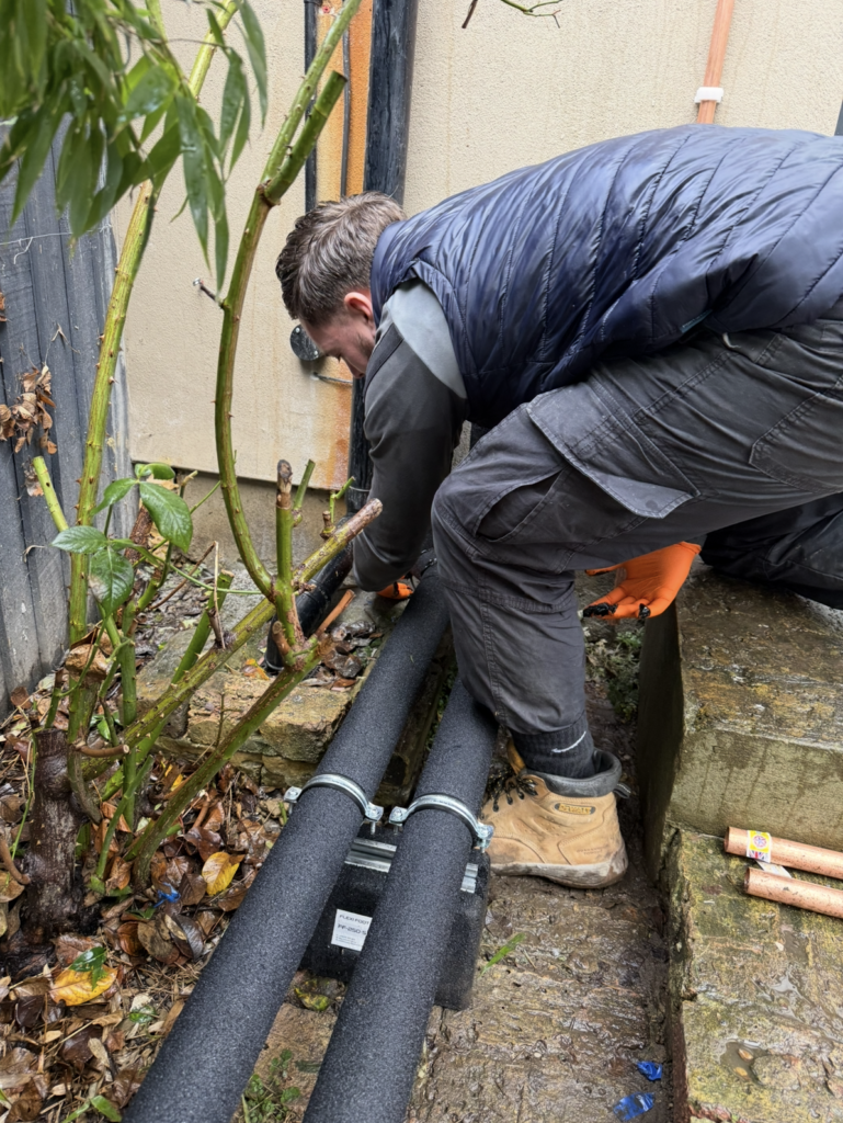

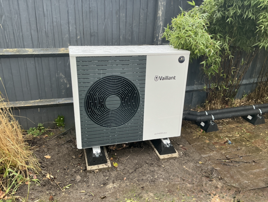

The pipework question is often where retrofits get complicated, and where costs can spiral. The instinct is to bury the primary pipes. The client did not want that, and in this case it was not necessary. We ran the pipework above ground on rubber feet, fully insulated in Primary Pro lagging, routed cleanly and deliberately. It looks considered rather than improvised, it is fully serviceable and it preserved both the garden and the budget.

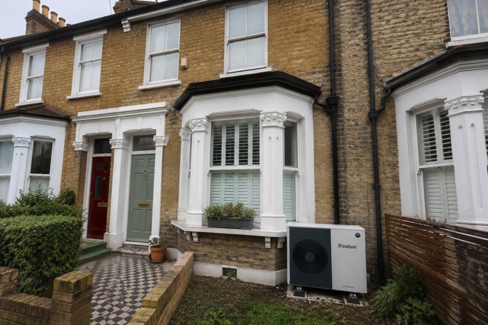

Where to position the outdoor unit was its own conversation. The homeowner initially raised the idea of the flat roof. After a proper assessment (airflow, access for future servicing, aesthetics) ground level was the right answer. It was not the shortest pipe run we could have taken, but it protected a bed of established bamboo planting and kept the unit accessible without a ladder. These are the kinds of decisions that only get made correctly when there is a genuine conversation between installer and homeowner rather than a site visit followed by a quote.

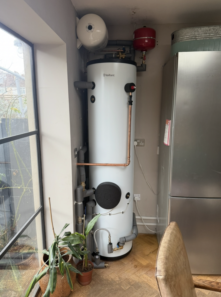

The indoor space presented its own constraints. The cylinder cupboard was tight, tight enough that the hot water expansion vessel had to be installed horizontally. That is not the preferred orientation, but it sits within manufacturer tolerances and is fully compliant. The controls could not fit in the cupboard at all, so they were relocated beneath the stairs, with power and communication cabling separated cleanly and routed for future accessibility. None of this is heroic engineering. It is just the kind of careful thinking that tight spaces demand and that too many installations skip.
