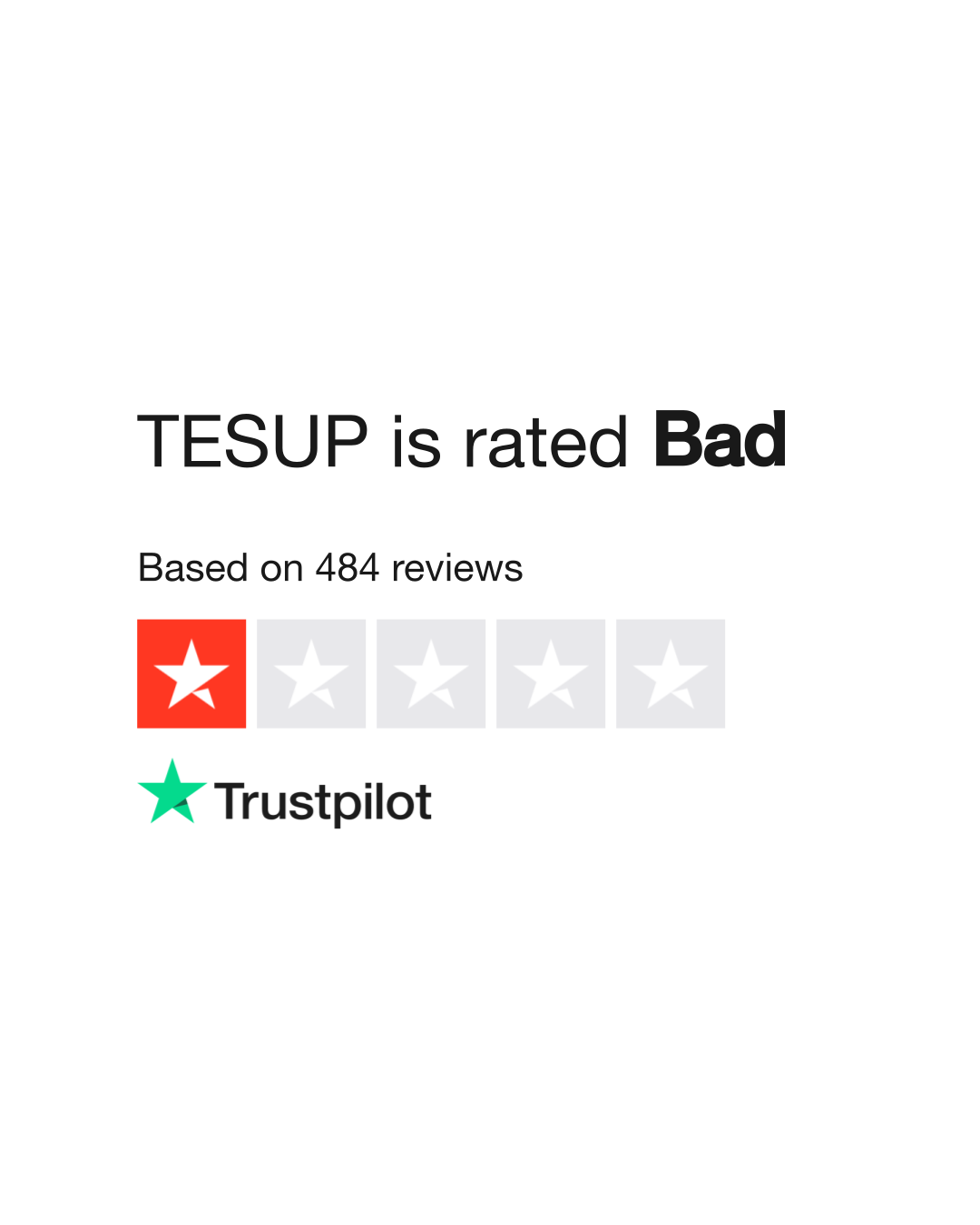

Hey @editor, https://uk.trustpilot.com/review/tesup.co.uk - in some cases it sounds like you'd be quite lucky to even have a product delivered!

Read some reviews of Tesup yesterday. Opinion was they are a box shifter in Turkey, delivery times were bad or the equipment ordered didn't turn up.
If the equipment did turn up it was substandard and poorly made...
They might be fake reviews but given there isn't much competition in the small to midsized grid tied turbine market I can't see why...
I don't have any personal experience of them and the reviews put me of getting any... sadly, as I love the idea of supplemental power from wind over winter.
