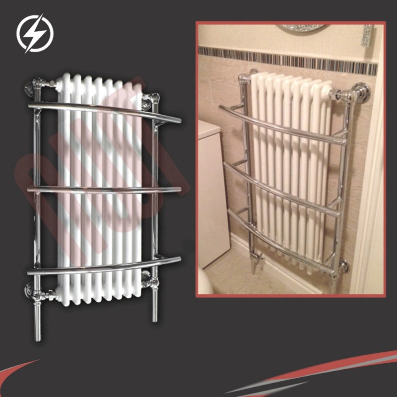

We had a separate electric old style radiator incorporating a towel rail installed. Heats the bathroom nicely too.
Like this:
