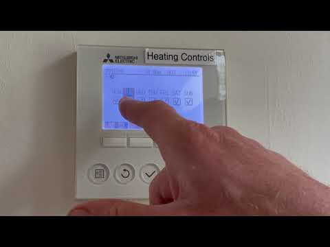

@carpenterstation Here is a video that shows how to program the timer. If you restrict it only to times when you want it to heat then it won't do anything outside of the those periods regardless of what the tank temperature is.
@gary thanks Gary. This is the video I used to set the timer.
so the question remains - why are the units cycling when neither heat, nor hot water are being called?
