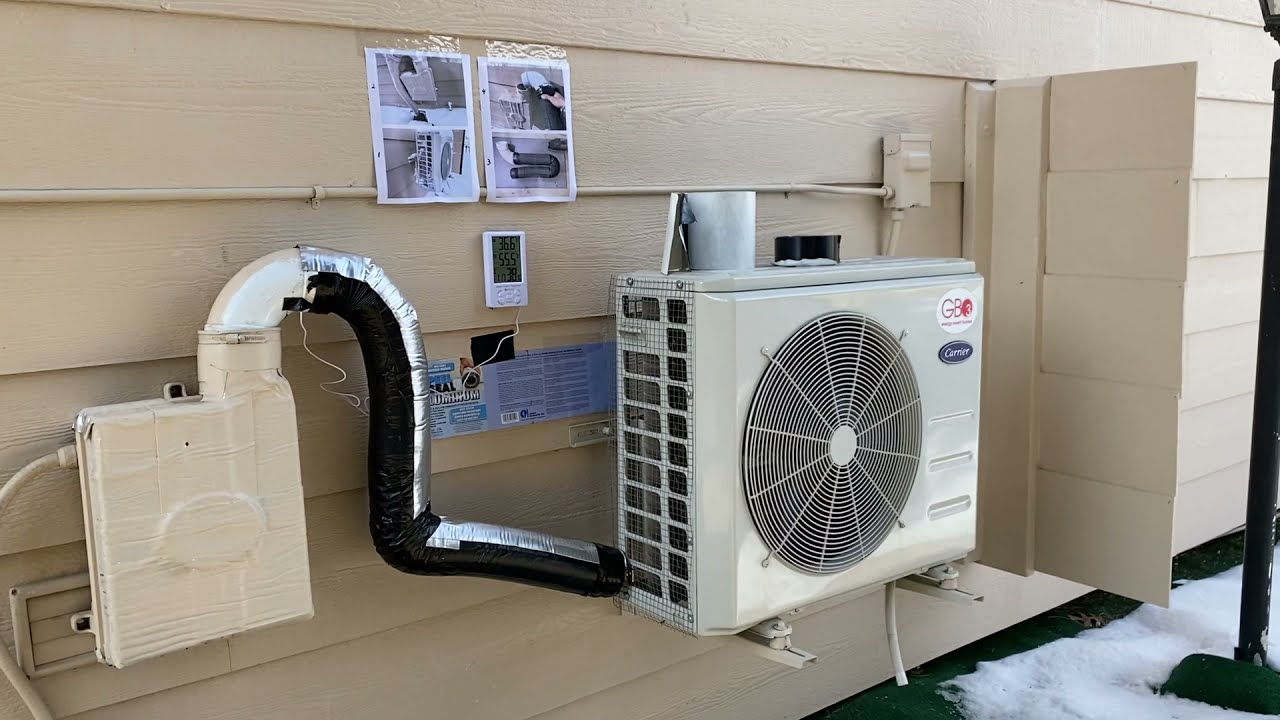

Posted by: @derek-mAlternatively you could buy a very large quantity of clean, dry, air (preferably warm) and use this as the air supply for your heat pump. 😋
Do you mean like this?
A bit Heath Robinson but maybe some clever person could design something more bespoke and market it to ASHP manufacturers.
Posted by: @sentinamPosted by: @derek-mAlternatively you could buy a very large quantity of clean, dry, air (preferably warm) and use this as the air supply for your heat pump. 😋
So instead of using the water to take the thermal energy out of the home, he uses the air. I wonder how effective it is in practice.
One possible way to keep the heating operating during defrost cycles could be to use a large heat store.
An alternative would be to have a small heat pump to provide the energy required for defrosting.
Whatever method is used, it will probably still use more energy.
