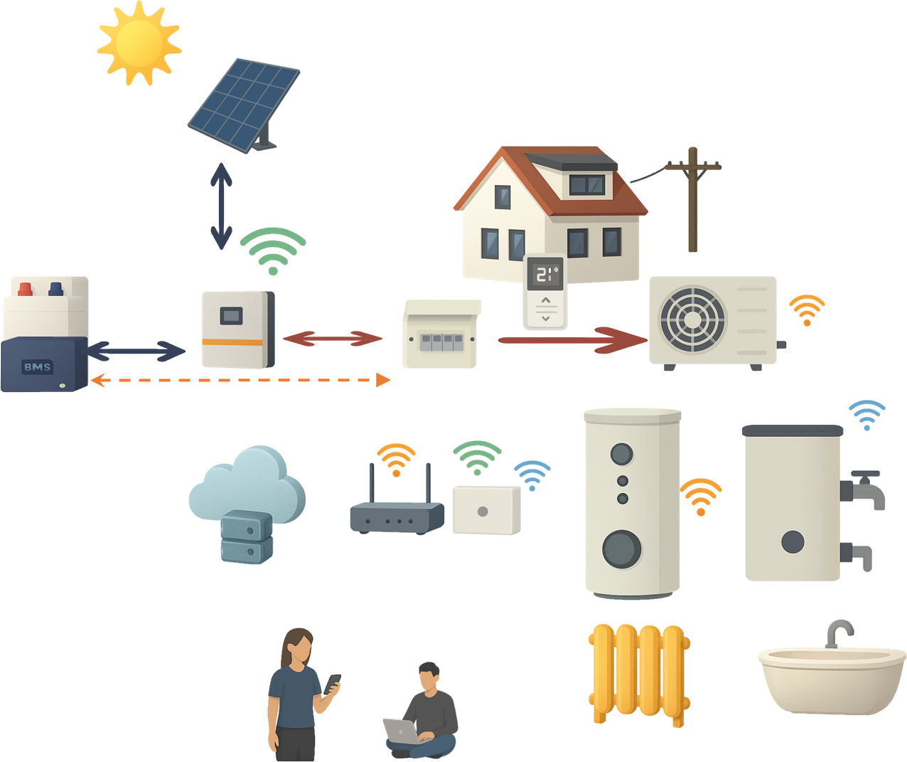

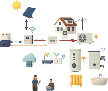

I feel your frustration — the heat pump is quite capable, but the app feels like a toy in comparison. It’s strange how one of the early “smart” players ended up falling short on this. Maybe too much of that R&D drifted into their ship-building division. 😄
Out of curiosity, what’s in your setup beyond the heat pump itself — a Samsung climate tank, maybe? And are you running only the SmartThings app?
I’ve been mapping what is interacting with each other in these systems, and I assume yours is a lot simpler. If you fancy, DM me a few details and I’ll update the diagram for everyone to comment on the gaps.

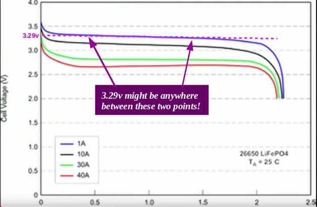

2: As for getting data from the Seplos BMS transferred to the Solis inverter, you are very likely to be disappointed.
The only data from the BMS which gets retrieved by the inverter is what is requested.
Seplos can't send out a "here's all my current data" package, and expect that 3rd-party inverters will somehow 'handle it' or 'store it'.
In common with the majority of inverter manufacturers who like to claim 'compatibility' Solis will be asking for the bare minimum from the BMS.
In most cases this comes down to what the BMS believes is
the raw battery voltage (ie not taking into account the present current-flow in or out
an estimate of the State of Charge (SoC) which is notoriously tricky to calculate, especially for LiFePO4 chemistry
In short, if you want specific data from an inverter, then instruct your micro-controller to retrieve it (Modbus over RS485)
And if you want data from the BMS, then do likewise.
You can't expect one Modbus-enabled device on the bus to pick up the data you'd like from another.

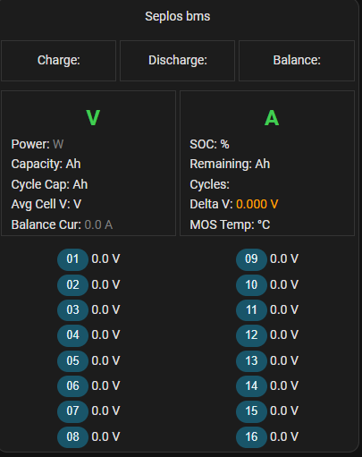

Potentially monitoring the BMS from Home Assistant would allow this table to be filled. I have not really thought what for, since the inverter seems to be able to get SOC. That should be enough to get a few integrations that also use tariff data (Octopus) to work. But perhaps an optimisation for the future...
To keep it simple, following some official instructions, I got the SEPLOS BMS and the Solis inverter connected using some chinese CAN protocol, I think Solis'. Fogstar recommends Pylontech. Eventually we will get there and maybe then it all works.
If not, I may need to use some of the ESPs I have lying around. And program them to repeat bluetooth..
