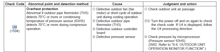

@editor I found some info in the service manual it could be a bad condensing temperature or pressure sensor.
It shuts down the heat pump if condensing temperature is over 70C.
Does anyone know what typical condensing temperatures should be?

@editor thanks Mars that’s the same table I found in the service manual it’s does feel like it’s the sensor that’s at fault. When it stopped it was reading 74C.
I managed to get the heat pump running this morning at 32C flow temp but the condenser temp was reading 65C so if you are correct this also points to a faulty sensor.
The heat pump has now been off for 3 hours and it’s reading 68C which doesn’t seem likely.
£400 later and it’s fixed it was the T3 sensor that measures the condensed refrigerant temp it should read single figures was reading 65C and occasionally above 70C which is when it trips the error.
