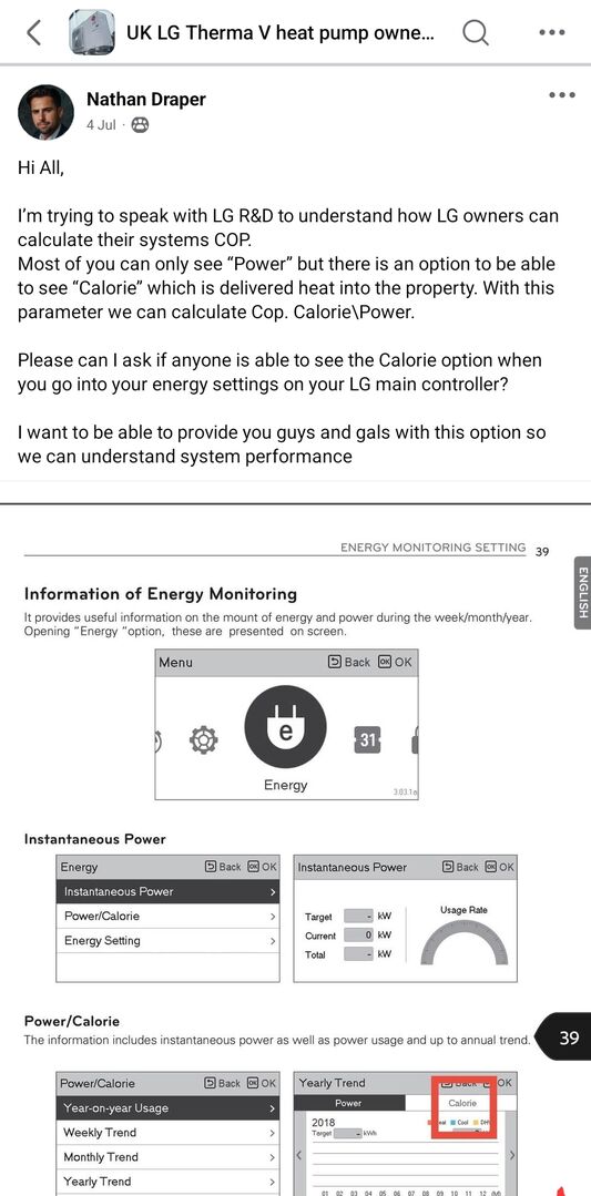

@tim441 Out of curiosity, how big and how well insulated is your house? And do you have any idea of how many of those 16kW you actually use at peak?
I tried quiet mode (it is still in it) and I also put the current limiter. Before that when it started it had peaks of 6(!) kW, now only 4.5.

@carlo the 16kw rating refers to output.. afaik?
So we might expect COP around 3.5 and therefore draw around 4.5kwh?
I think I occasionally see that sort of draw in winter - especially if heating DHW to higher temperatures. But I believe my "normal" usage running the heating on AI is running around half that - or less.
I can see my annual use is 5800kwh for heat pump as it has a dedicated meter. Peak months around 1000kwh so perhaps averages 30kwh per day. But of course coldest days if freezing temps day and night we might use say 80kwh?
I don't monitor day by day - only monthly. We are in SW England where winter is generally relatively mild.

@carlo I see there is a discussion in Facebook user group. May be useful to read fully the comments - no easy answers!
