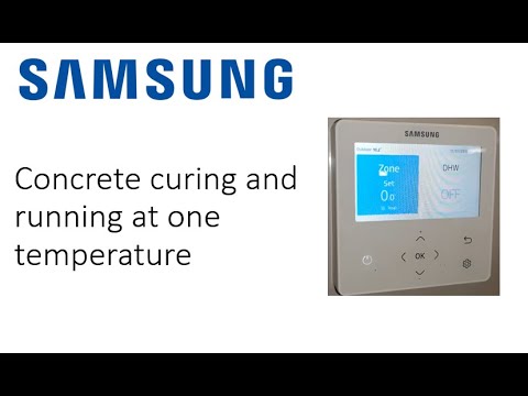

Thanks Craig. What setting are you on now for 2092 and 2093? Also I note that you ran it for a short period without weather compensation at fixed flow temperatures. Can you outline the steps you took to do so? I can't work out how to do that.
Â
I'm on value 2 that says pump 1.
Â
I used this YouTube clip to get away from WC. There is probably an easier/better way but this way served it's purpose.Â

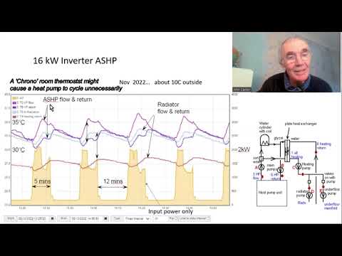

This is my heating run cycles today.
Â
Heat pump installer
11 years ago this was easy ken. But much harder now. Units over the last couple of years don't ramp down much below 30 or 40%. And they really hate running sub 30c flow. It's all to do with the low cops you get at low compressor speeds. Because of the wired obsession with cop not run cost the manufacturers cycle the unit as it gets a better cop. But not necessarily lower run costs.Â
