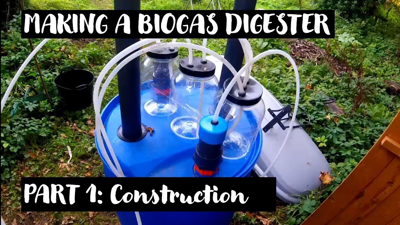

If you want to have enough gas to cook with, but without buying it in and paying the standing charge,
then you can make it from your own DIY Biogas Digester.
There's plenty of tutorials online.
