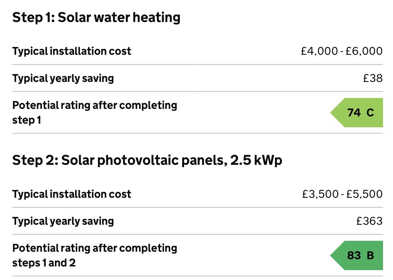

Having carried out extensive work to further insulate the property with triple glazing replacing the old double, fitting solar panels and energy storage plus a solar power supplied DHW and an ASHP, I have almost been tempted to have a new assessment carried out - chances are though that the ‘score’ might have dropped! 😉 Regards, Toodles.
The guidance I was given suggested a regime that I consider fitting solar heated DHW and some solar panels; I have more than ‘leveraged’ my setup as I have added far more (8.1 kWp. of solar panels plus battery storage too as well as a Sunamp Thermino for the DHW) Then there is the heat pump - oh wait a minute … that probably means I have knocked the figure back and my ‘C’ has become a ‘D’ rather than a ‘B’!😉 Regards, Toodles. (Extract of improvement advice attached)

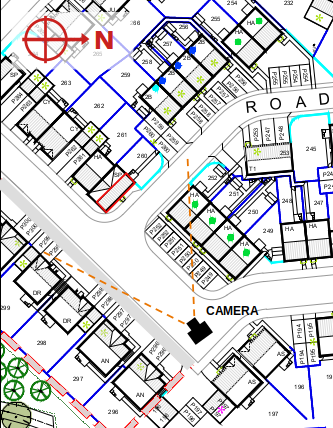

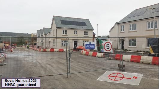

What does the SAP/EPC scoring method have to say about the orientation of the solar panels?
Does it still count as 2kW if the developer has placed the six panels on a section of the roof facing north-east? 🤔
@transparent Nothing on the south west side??? Toodles.
And further more, why so few panels fitted as there is obviously space for far more? If one has gone to the effort to fit a system, I would nave thought making the most of the space would be advisable. Rewards, Toodles.
The house is T-shaped @toodles.
The SW side has another part of the roof at right-angles to what's visible in the photo.
I would've put PV on that section facing SE, because it's still plenty large enough to have the six panels fitted to it.
But let's not get carried away and suggest that a national housing developer could use common sense!
@transparent Along with the right workers, they can’t buy any common sense.☹️ Toodles.
