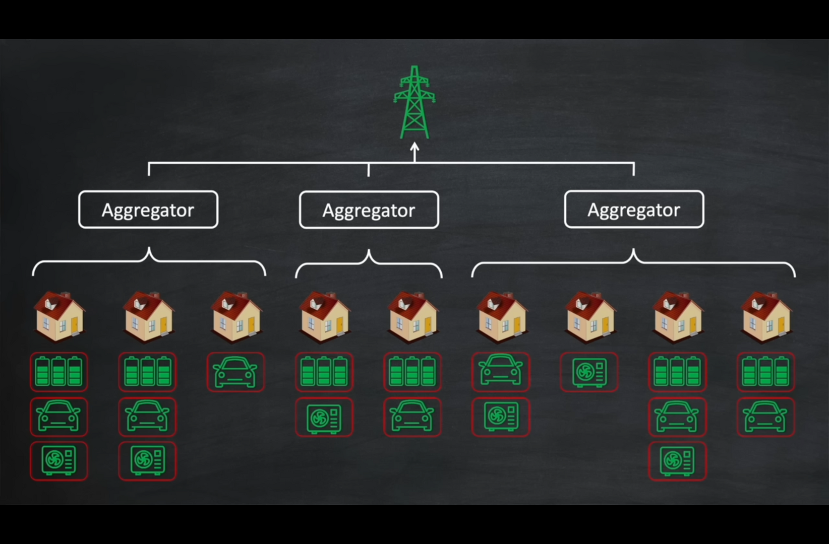

I also saw this video by Gary Does Solar… and his predictions on export tariffs and the risk of them dropping, not just here but across Europe.
My attention was also drawn to the possible introduction of aggregators - possibly our energy suppliers? who may take control of the rewards offered to home owners for home energy generation. Gary’s own words describe some scepticism-
“Will those aggregators fairly distribute those rewards back to home owners who are enabling this (solar generation)”
It’s easy to anticipate that as the solar generation increases to provide a reliable capacity the rewards may become less generous.  it may be I am overreacting because I’m not invested in PV solar as yet but I would welcome a clearer picture of the future benefits.

@sunandair Another point to consider is whether those virtual aggregators would be regulated by Ofgem. From what I hear from some family and friends in Australia is that such VPPs might not always distribute the benefits back to customers, like you have pointed out.
IMG 0151
@sunandair therein lies the issue - no one can say with any certainty what energy markets will look like in 12 months time, let alone over the payback period of any investment. For now, solar is relatively cheap to install with good payback. If you have or are planning to get other electrified technology such as EV/ASHP then that can only help the economics should SEG rates for export fall.
