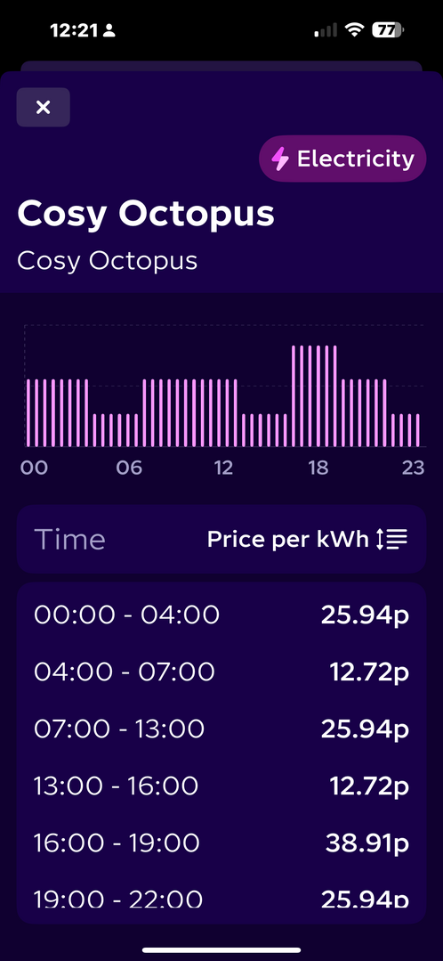

@sunandair Without battery storage, I am not sure that OE’s Cosy would provide any benefit, but here are the rates in my area (SE). Regards, Toodles.
