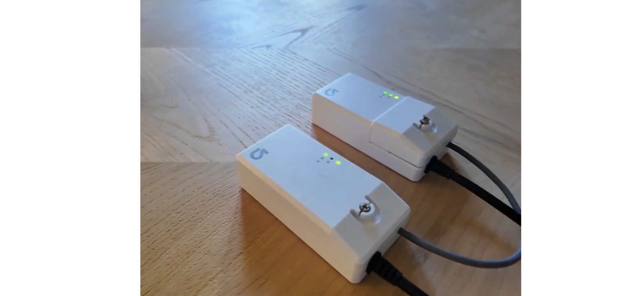

There are some projects looking at how smart meters and the smart meter network can be used in demand management.
Here is one for example
Whether the network is ever utilised at scale in the real world in the UK I have my doubts, just like I thought zonal pricing was a non starter for a variety of reasons not just politics around constituency voters. Getting investment into the UK generally right now is just a bigger problem as votes.
If you focus too much on the HAN etc to control demand you may end up frustrated I fear. But obviously up to you. So much money has already been invested elsewhere already it may already be a done deal.

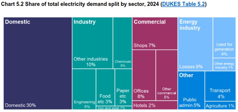

Posted by: @jeffCirca a third of energy consumption in the UK is from residential
The Digest of UK Energy Statistics Chapter-5 published last week shows 2024 domestic electricity consumption at 30%.
Note that Energy Industry Losses are stated at 9%.
However, those losses are dominated by the effects of phase imbalance and harmonics induced by domestic consumption.
That's because a high proportion of commercial/industrial electricity demand is 3-phase.
Smart Control of domestic use could significantly reduce those losses at the local sub-station.
But the approach being made by Salford/Hildebrand doesn't address this issue, nor the constraints on the area Distribution Grid.
