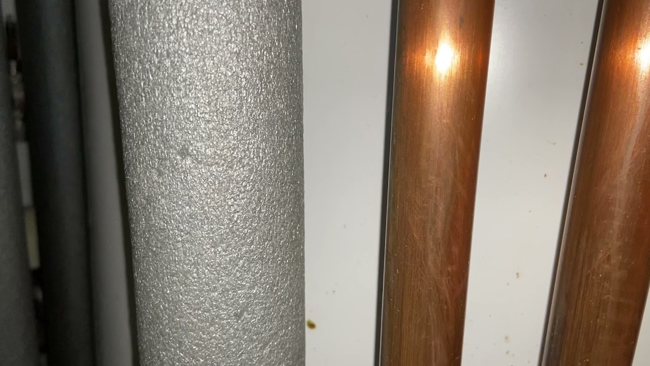

I've posted a 10-second video below to illustrate the sound. There's nothing exciting visually, just some pipes. The sound in this video is more of the dripping, running water sound. Will try to capture the gurgling later.
