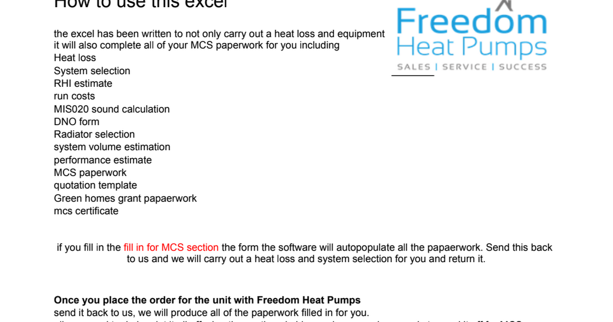

Thank you both.  I got it to repair and open in Excel but it has excluded some data to do so. Will try Sheets
(@batalto)
Posts: 1092
This is V3.3 on Google Sheets - https://docs.google.com/spreadsheets/d/1fI91GF163YuRITqNjPzBjlBfk1RT63ep8SxjkiIcp34/edit?usp=sharing

@abernyte Thanks, I've drawn out my house schematic (and associated rad list) and started a few initial measurements. I was going to start with the Freedom spreadsheet (as it felt a little more accessible) and then build to the full MCS one. Hopefully getting a full set of detailed measurements will allow me to get through both.

To report back on progress, I've had a good go with the V3.3. Freedom spreadsheet but get overall losses in the 11.5 kW to 14kW (70 - 90 W/m3) region depending on what construction materials I select.
