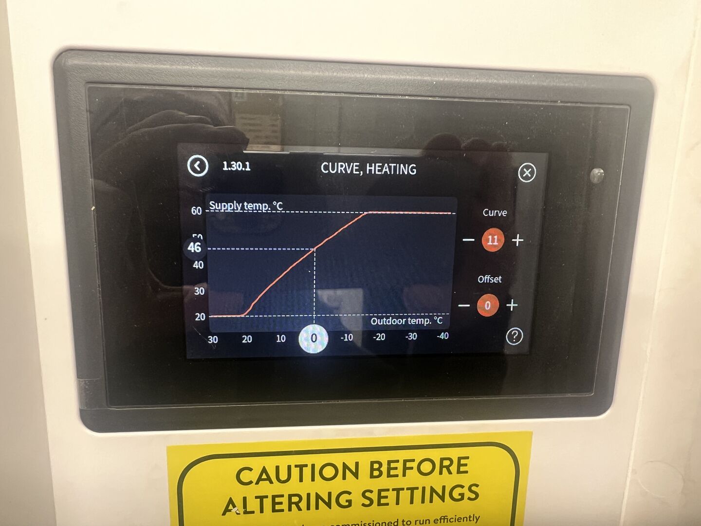

I’ve attached a photo of our heat curve. Firstly, it looks like the maximum supply temperature that’s been set by the installer is very high at 60°. I feel like I should reduce this. I’m also considering undertaking the task that is detailed on this forum of using the thermostats as limiters and just using the weather compensation curve on the heat pump. I’ll wait until the weather is colder. The Weather Control setting is currently off. There isn’t a lot of information about what this actually does, but it would seem that it checks the weather forecast and adapts its behaviour accordingly. I would be grateful if anyone has any knowledge of this feature and whether it’s worth enabling.

- Your heat loss calculations should include a design flow temperature at the target outside temperature of -3C. I would hope for a number of maybe 35C. Certainly, a 60C flow temperature in an underfloor heating system is much too high. A hot shower is about 40C. A floor at 60C would burn your feet and ruin your floor. I am not an expert, but I think even 40C UFH is considered dangerous. Therefore, set the weather compensation curve carefully before you turn it on.

Posted by: @sbm74and just using the weather compensation curve on the heat pump. I’ll wait until the weather is colder. The Weather Control setting is currently off. There isn’t a lot of information about what this actually does, but it would seem that it checks the weather forecast and adapts its behaviour accordingly. I would be grateful if anyone has any knowledge of this feature and whether it’s worth enabling.

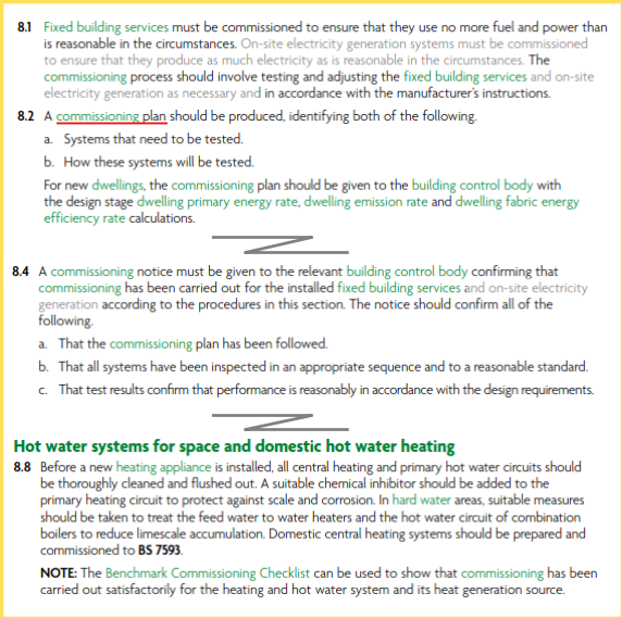

... and therefore doesn't comply with Building Regulations, Part-L
Moreover, Part-L, Section-9 stipulates that the homeowner must be provided with documents and instructions such that you can verify the efficiency of the installation,
and therefore be able to maintain it to use as little energy-input as possible.
This set of documents must be site-specific.
Handing you a folder with all the manufacturers' instructions for each component of the system does not comply.
My understanding is that the OAT is being used. NIBE Weather Control seems to be an additional feature that looks at online weather forecasts and uses this information to help predict heating requirements.
Ah. That sounds better.
So that just leaves the heat-pumps in a battle whereby OAT-based weather compensation is being thwarted by thermostats turning zones off/on.
Posted by: @grahamfA floor at 60C would burn your feet and ruin your floor. I am not an expert, but I think even 40C UFH is considered dangerous.
I agree.
The absolute maximum I would expect to see for water entering an UFH manifold is 46°C.
The actual temperature you require depends on what the pipework is embedded in, and what material the floor surface is made of.

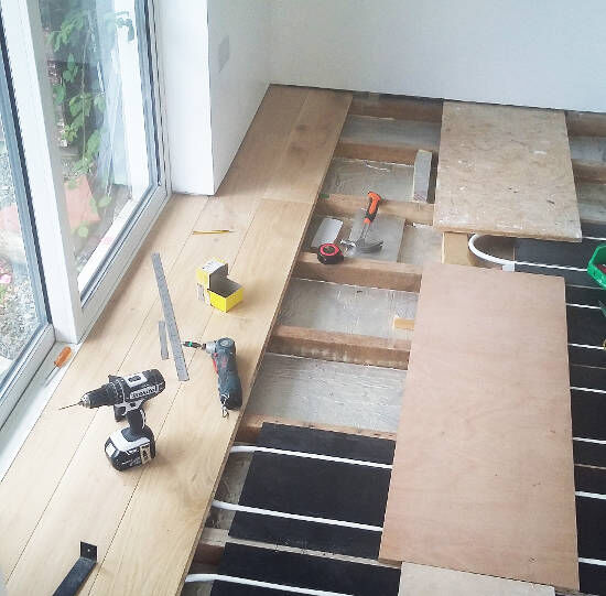

Do you know the composition of the floors which have UHF?

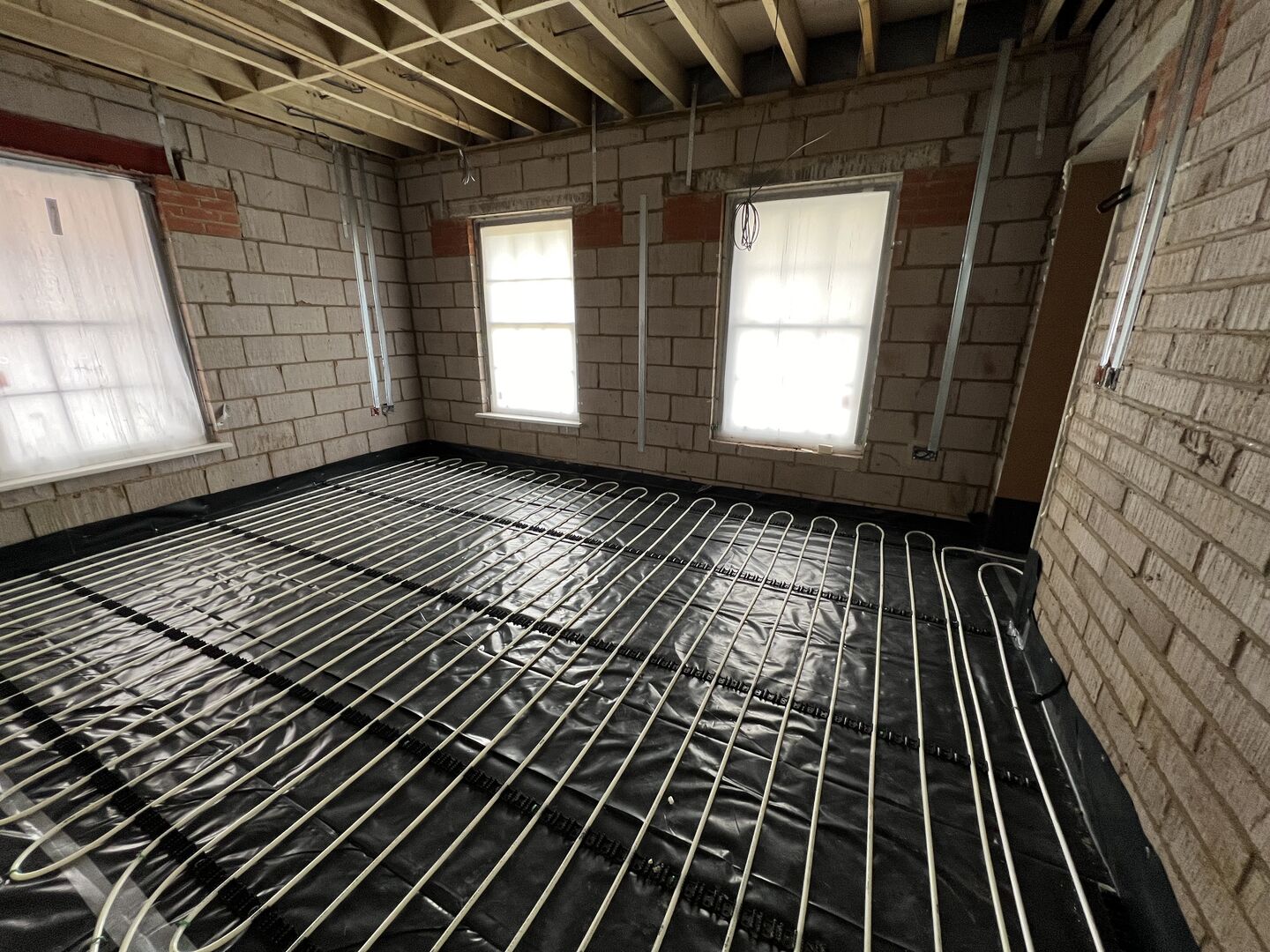

Do you have any photos of the UFH system being installed?

But, 60degC max flow temperature - eh, what, why? Building regulations also set the maximum design flow to be 55degC these days, and for UFH you'll only need something like 30-35degC if the system has been designed properly for an ASHP source (i.e.: 100mm spacing on the piping in the floor).
Has your installer used underfloor heating blending thermostats on the manifolds to each zone? It could be your ASHP is set to kick out a far higher temperature than will ever be needed or is appropriate for UFH. The old school way of getting round a fixed non-modulating fired gas or oil boiler that could not supply heater water at less than 50-60degC was to blend [mix] high temperature flow from the boiler with water leaving the underfloor circuit to a lower temperature. From a thermal efficiency point of view, with electric heat pumps, that's thermodynamic lunacy! You're paying high and handsome in electricity consumption to generate water at far higher temperatures than is needed.
It sounds like you have a massive opportunity to de-clutter your system of things it should never have been fitted with, go open loop and set the ASHP to weather compensated control at a much more suitable system maximum flow temperature of around 35degC. 60degC might be the maximum flow the Nibe F2040 ASHPs can provide, (they use the rather obsolete R410a refrigerant gas), which is fine to generate your hot water and heat your cylinder, but should never be used for space heating.

The photo you've just posted of the pipe before screed is poured:
Is that a single loop for that room?
There appears to be only 1 pair of pipes coming through the doorway.
