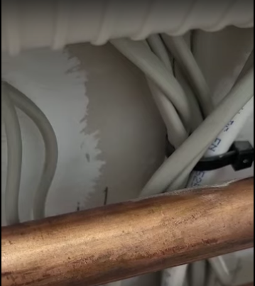

Here's a still from your video:
Not only are those wires attached to a heating pipe by a tie-wrap (ugh!), but they look suspiciously like solid-cored twin-and-earth (T&E) lighting cable.
They should be flexible cables... and heaps thinner because an actuator typically takes 3w (about 12mA current)!
I'd also be using 'heat resistant' flex that close to a domestic heating system.

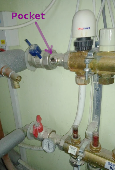

Posted by: @newhouse87Where can i see temp flow and return? Have no temp gauges on manifold.
There's usually a connection piece between each manifold level and its isolation valve.
That has a 'pocket' in it, which can accept a thermometer or a digital temp-probe.

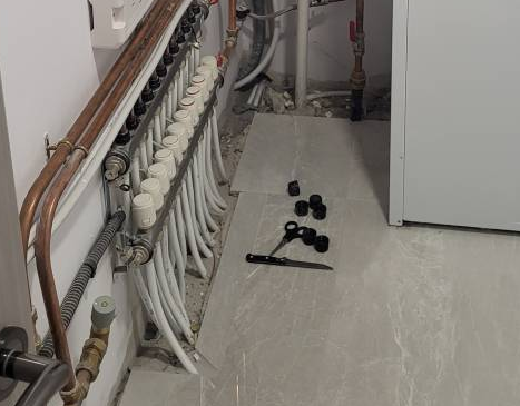

Returning to your earlier photo; do these UFH pipes all go directly into the concrete floor?
... or are most of them running through pipe insulation until they reach the room where they're actually intended to export their heat?
If there's no insulation around any of them, then all 12 circuits will be heating up the same concrete pad in the room which has the heat-pump.

@transparent all pipes are going into screeded floor that has i think 6 inch insulation on top of base floor. So pipes were layed directly on top of insulation.
