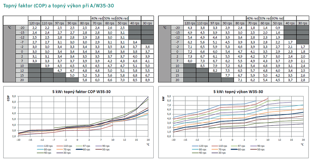

Mick Wall shared some Polish documents on the Vaillant aroTHERM: https://community.openenergymonitor.org/t/vaillant-arotherm-owners-thread/21891 It shows that a 35/30 flow would result in a min output of 3.5 when it's 12 outside. As the flow temp increases the min output lowers and at 55/47 it's 2.6. The COP drops a lot of course.

You will need to go hunting for the performance tables (like the Vaillant one) for the models under consideration, as min output is rarely published other than buried in these. Remember you need the min output at the max OAT not at the min OAT.
In general terms modulation depth appears (where it is published) to be about 2.5:1 - 3:1. The gotcha to look out for is badge engineered models where more than one 'variant' is sold with the max o/p limited in firmware. Daikin, Midea do this big time. The Vaillant 5 and 3.5kW models are said also to be the same. You can tell by looking at physical dimensions, weight and refrigerant charge in the spec table. If they are the same between two different models, its a pretty sure bet that the lower power one is simply the higher power one with a firmware cap. The minimum output will be the same for both, so the modulation depth of the lower output variant rather less.
You need the performance tables anyway because sticker capacities are nothing like actual capacities in many cases, and anyway vary (in most cases and thermodynamically) with OAT and FT. The Vaillant '7kW' machine is good for about 8.6kW at -3, a typical design temp in the South East of England, whereas the Daikin machines appear to be 'tweaked' in various ways so it depends on the details. Samsung do cap their outputs at the sticker number and Mitsubishi do likewise, so as long as the design OAT is sufficiently high you get what it says on the tin. Midea, in many cases, have lower actual capacities than the stickers would indicate.
