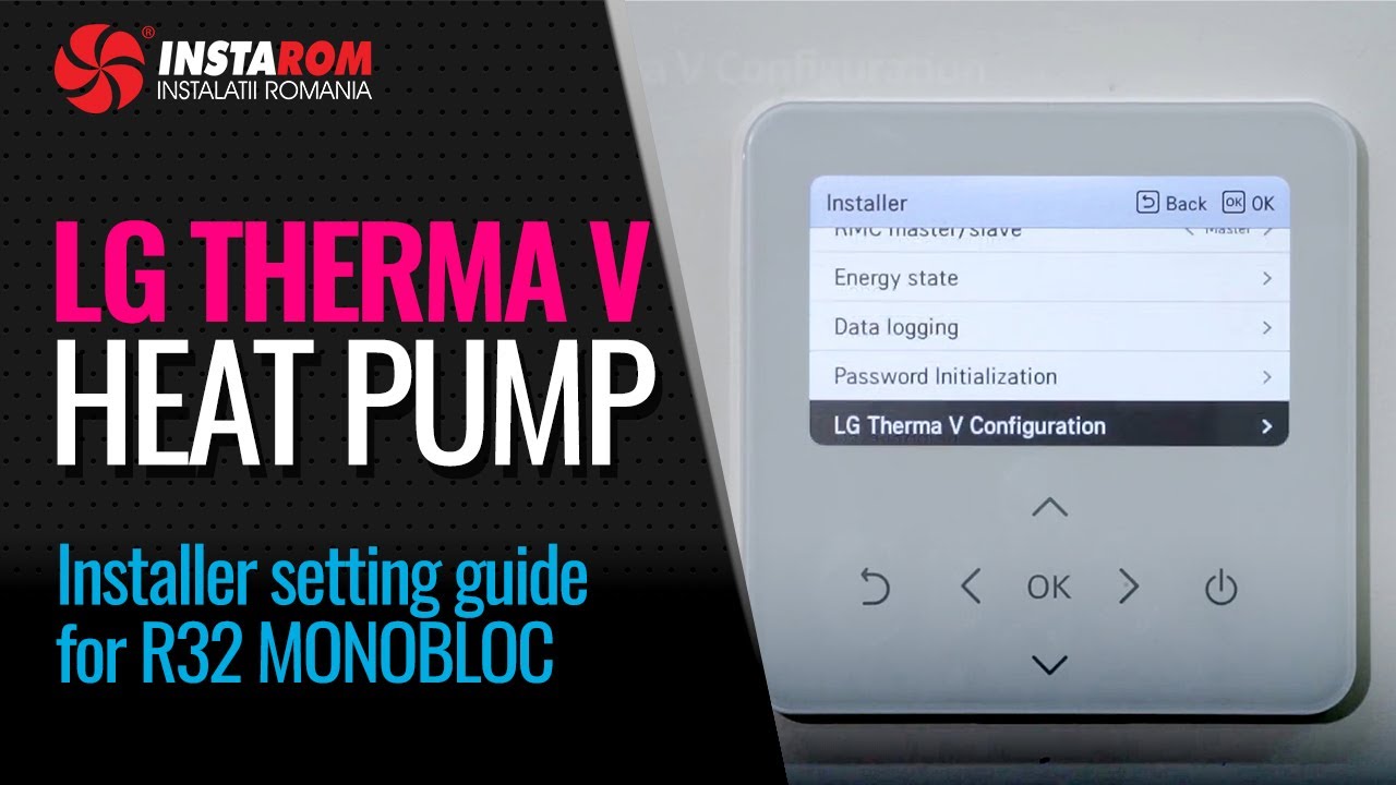

A very useful official video on controller settings
Somewhat frustrating as it jumps around in different order to settings so needs stop start! But helpful...
Most noticeable change in change to Auto/AI on this first day is that the flow temp from the unit is sub 30deg and was 27deg when last checked! However its important to note the outside temp is around 13 deg so the ASHP is not having to work hard to maintain 21 deg in main living areas.
