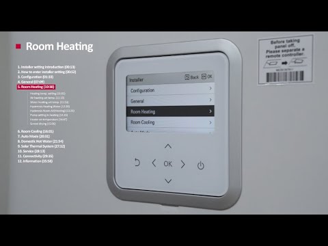

Hi, Im trying to get to grips with the LG settings for a friend so Im not expert but this video
suggests Optimal might be the way to go. However this video is for the split unit rather than the monobloc
