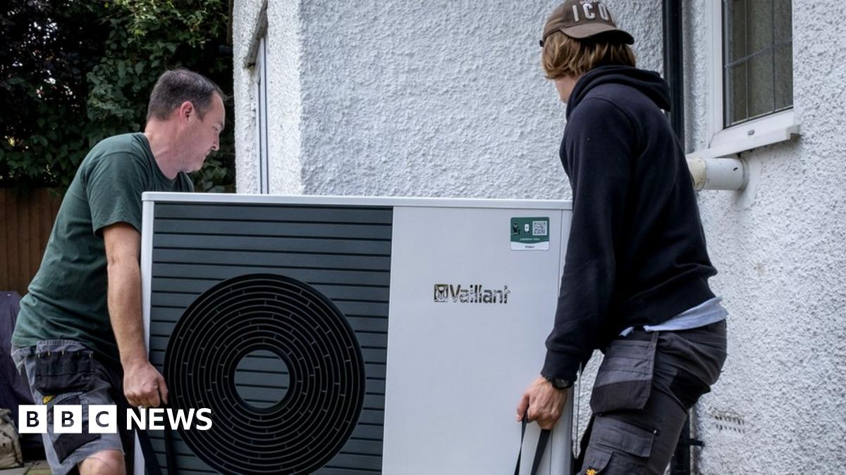

No surprise to me to see a high temp pictured sadly. There's obviously going to be a big push for these regarding the retrofit market but running costs are higher than for a standard pump, and you don't see that in the headlines.
I've seen that a few of these have been gifted to some influencers and the set up with the hydraulic module and all lagged and correct sized pipework etc. etc. in what looks to be a garage or pumproom is probably going to be very far removed from what the average person will end up with if my experience is anything to go by!
